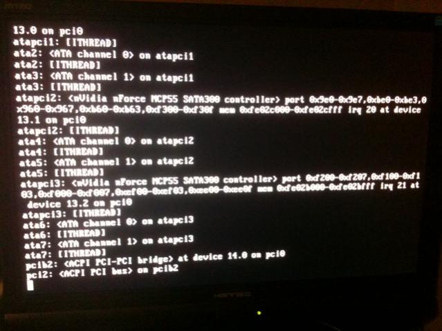

So just to further complicate this... Now, everytime I attempt to boot into fN I get to passed the countdown menu screen and it continues to boot up to the point in the picture. I cannot get freeNAS to finish the boot.
Any ideas? I am getting close to just throwing in the towel entirely. Followed by my computer in the nearest lake...
