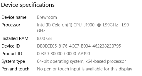

I first tried building a system with an older HP computer. I could never get it to boot. I have a different computer with an ASRock Q1900 motherboard. Here are the specs:
Has anyone successfully built a FreeNAS system with a computer like this? If so, did you run into any problems and can you offer any suggestions on how to overcome them? Thank you.

yep, had the same board and got freenas stable running on it, after 5 days playing with all the bios settings
Brewboy
Sep 13, 2020
14
Do you recall the BIOS settings that needed to be changed? When I tried to get it running on that HP machine, I tried every setting possible, but nothing worked.
John Doe
633
cannot recall the settings for the AsRock board. It was >7 years or so
but I found some screenshots during that time, which were helpful.
use of legancy, only usb2, deactivating all but crucial things
back in the days i created a matrix with every possible setting in relation to the others to really try them out. it took a while until i got it working but then it ran very well.
btw. I dont know your usecase, that board might suit your needs. But there was a reason for me to change to proper hardware.
you have one of those terrible realtek network adapters. dont expect higher transfer rates then 80mb/s

@Brewboy Just me being curious: but what are you planning to do with this system? I won't bother you with the suitability of your components because the hardware requirements/recommandations are easy to find. But memory and CPU are on a minimum. Especially if you want to let Plex loose on video transcoding. Your CPU will not handle that very wel. A simple 720p transcode (1 stream) needs a CPU wit at least a 1500 passmark score and your CPU has a pasmark score of about 1100 according to cpubenchmark.net. Ofcourse without transcoding your CPU will have more of a chance to do the job.
