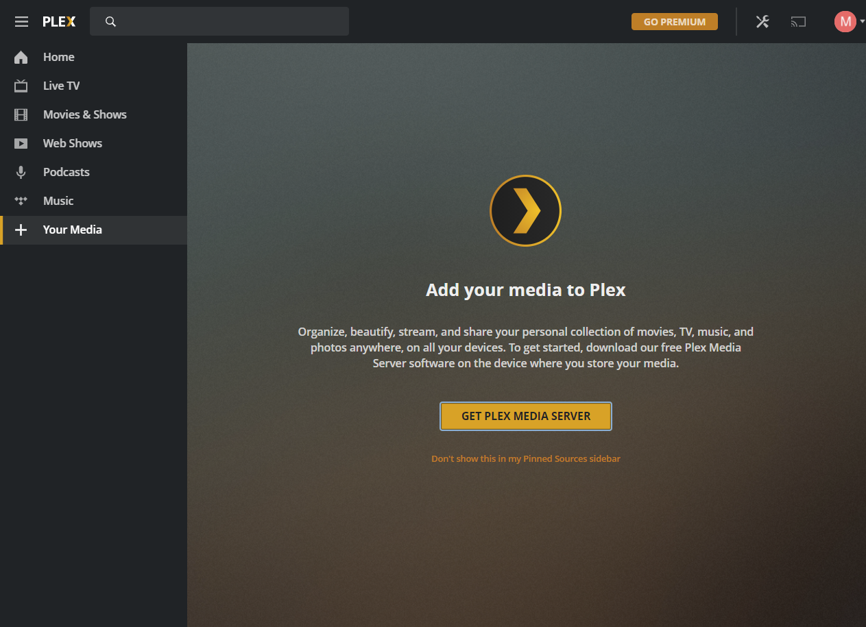

Well I got it installed just the way ThreeDee described and it is starting up. So thank you for that , I mounted the media volumes , but Plex decides not to show my media , but I am sure that's a plex issue as it decides to do the same thing on my freenas now. Thank you for all your responses
