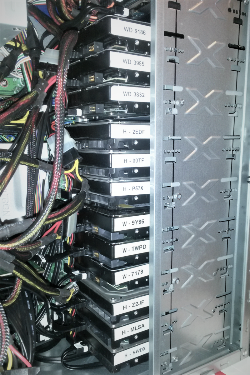

I have said this in other threads but I will try to give a unique take on it so it isn't so repetitive. A few years back, around 2013 or 14, I built a tower system from parts and I sourced all the drives from eBay, six WD drives and six Hitachi drives, all with some use on them.
Photo:
The system didn't have hot-swap bays and it made me very irritated for a number of reasons.
- I had enabled deduplication which made performance abysmal.
- I had used RAIDz3 and I blamed that (in part) on the poor performance.
- I couldn't get by for more that a month (maybe two) without needing to disassemble the thing to swap out a drive.
It was because of my experience with this system that all of my systems since have had hot-swap bays.
I paid less than half as much for those drives as I would have paid for a new drive, but I paid for that savings with hard labor.
This experience is part of the reason that I keep two (or more) spares for each size drive that I use, even now.

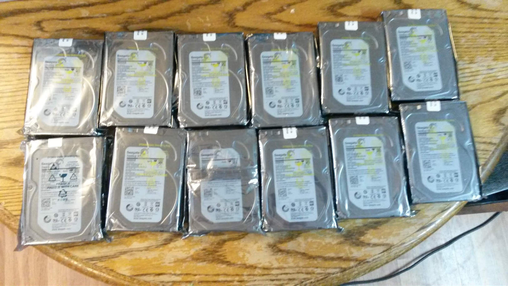

I bought a whole case of drives around the end of last year and some of those drives were dedicated to being spares.
This is 12 of them as I was getting ready to put them in my server:
I use DBAN and do a DOD short wipe with verify between each pass as a test for my drives.
It does a very similar thing to the burn-in script on the forum, but I find it a bit easier to use.
I am not saying to only buy new drives though. I have had problems even with new ones.
I bought a batch of 8 Toshiba drives in the early part of 2017 and within six months 3 of them had hard failed.
Any drive can be a dud. I have had pretty good results from the Seagate Desktop drives.
If I remember to do it, I will post a photo when I get home with a side by side of the Seagate Desktop and the Seagate Barracuda.
They are similar but very different drives and I am not sure I trust the new Barracuda drives, but I have two of them I plan to test...
