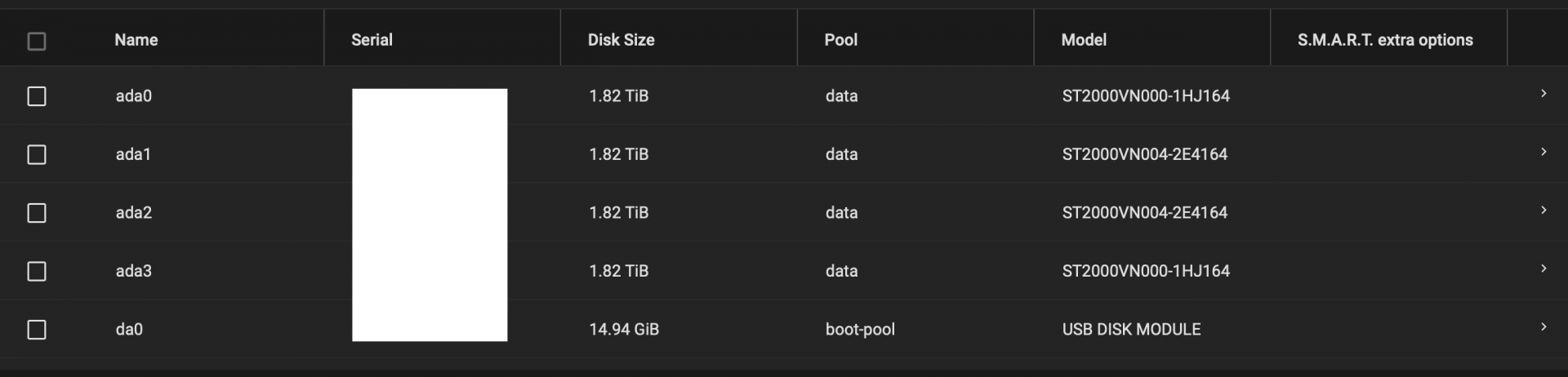

I just migrated my boot pool from a external USB3 M.2 SSD to a eUSB DOM and was successfully able to restore the config backup.
TrueNAS automatically remounted all the dataset pools, including jails and plugins.
1. Save config via GUI (export secret seed)
2. Manually backup /root/.ssh/ folder
3. Install TrueNAS CORE on DOM (UEFI mode)
4. Restore config via GUI
5. Restore /root/.ssh/ folder
The only caveat is I restored a config backup that was generated using the same TrueNAS version.
