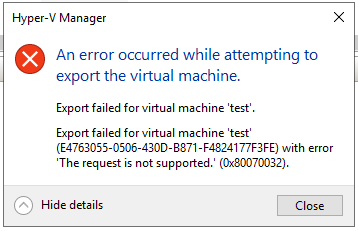

I can't export Hyper-V virtual machine on Windows Server 2019 to TrueNAS SMB share. The configuration level of virtual machines is 9.0. I receive an error:
I don't think it's a basic permission issue. I have full permission for the user account that exports the VM and also for the system account of the Hyper-V host. I have noticed that Hyper-V VMs with configuration level 8.0 export just fine. I think it's maybie some issue with samba that it doesn't support some commands that WIndows sends. Export to the Windows computer or server that hosts Windows share works fine.

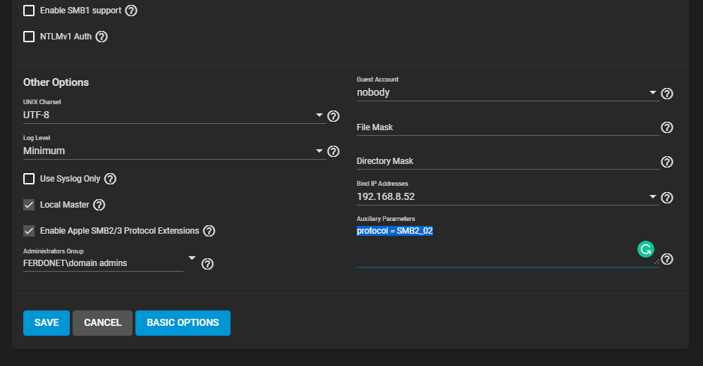

My problem is now solved I have downgraded SMB to SMB2 version 2.0.2, later versions don't support FSCTL_LMR_REQUEST_RESILIENCY feature which should be available from version 2.10.
To fix the issue add protocol = SMB2_02 to Services -> SMB in TrueNAS
This is the link from the thread mentioned above that describes the issue: 9938 – Create VM fails on Hyper-V 2012 (samba.org) this bug is old (2013). But it wasn't fixed as one person from 2021 have said, it's still present. But the interesting thing is that only Windows Server 2019 version 9.0 VMs are affected. Probably they started using this feature for exports as well, not only to run VMs from SMB Share.

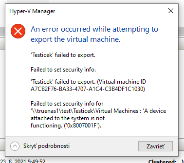

I have another issue. I can export only VMs that are turned off. When I export VM that is turned on I will get:
I have permissions for the computer account and the user account that initalizes the export. Currently I am testing various SMB versions on TrueNAS

My temporary solution is that I have created VHDX virtual hard drive on SMB share that I have mounted in the Hyper-V host. The only thing I need to resolve is that It only allows only one computer to mount it.
