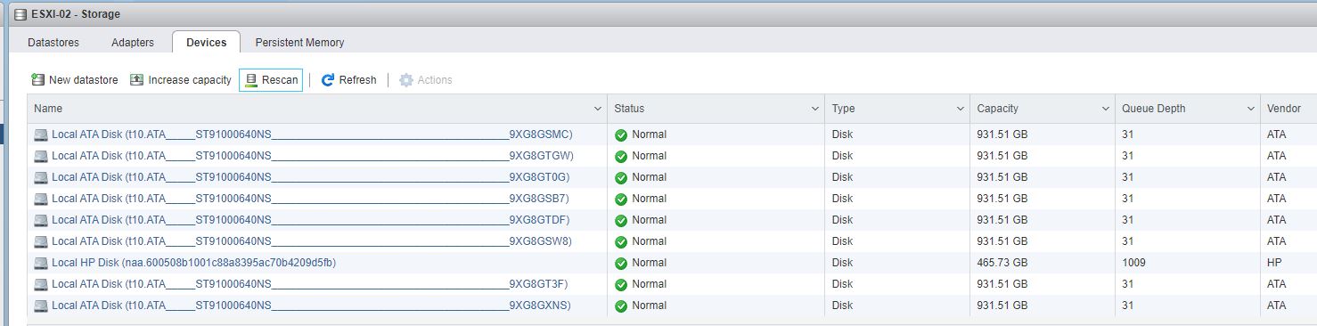

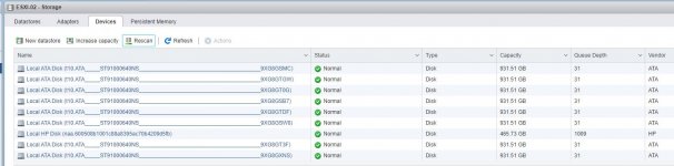

thanks for the link, now is there a document on setting up the controllers? at this time my server can only see 8 of 16 drives
9,700
If I remember the options on a DL 380 Gen9, there are several backplane configurations that were offered... some of them split.
How have you connected your HBA to the backplane and what option do you have?
thegreek1
Sep 20, 2020
21

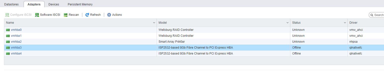

This is what I have to work with. The only HBA is my fiber cards
Yes, the document on setting up the controllers is the one above where it tells you not to use it. The "remove it and replace it with an HBA" is, I suppose, implied.
This is not going to work out well. ZFS will throw crushing amounts of I/O at a storage array and an 8Gbps link to the host can only work for maybe three, possibly four drives before it gets flooded out. This has been discussed in the past and you really don't want to try it.
