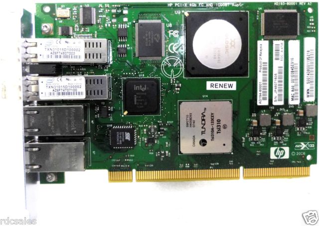

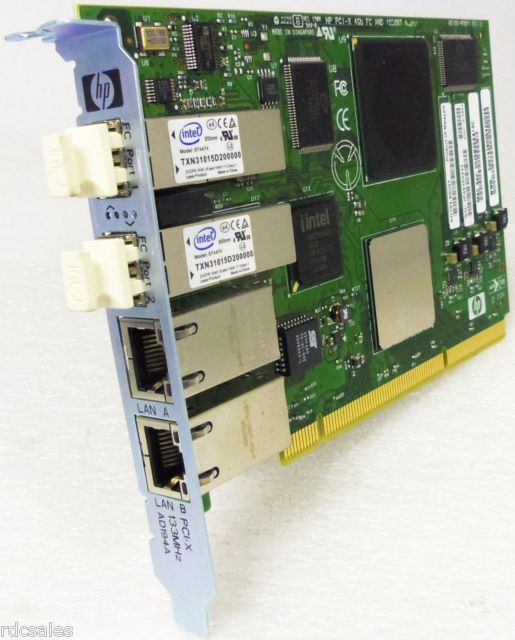

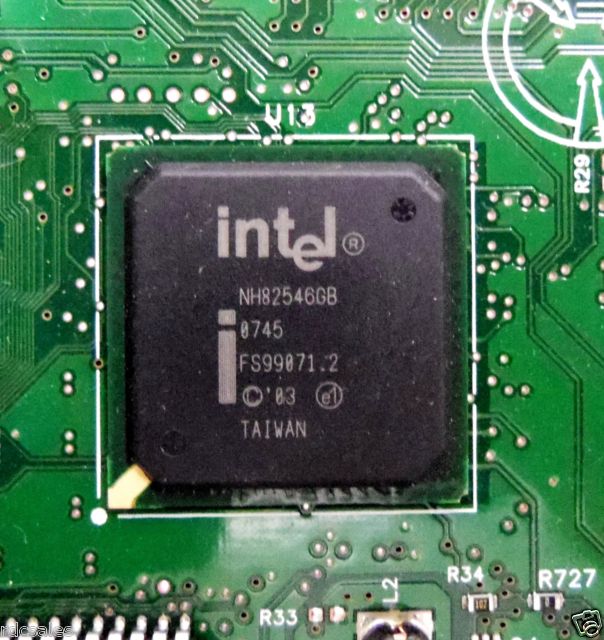

steve001
Sep 30, 2013
34
here are pics will have a look at the link tonight , hope that it will work :) with freenas
