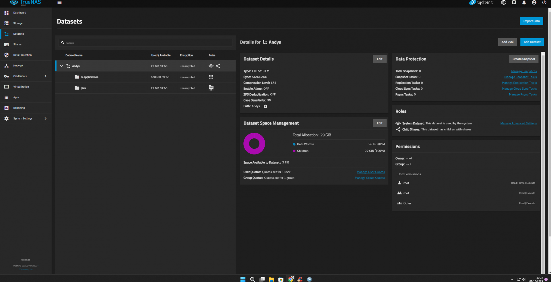

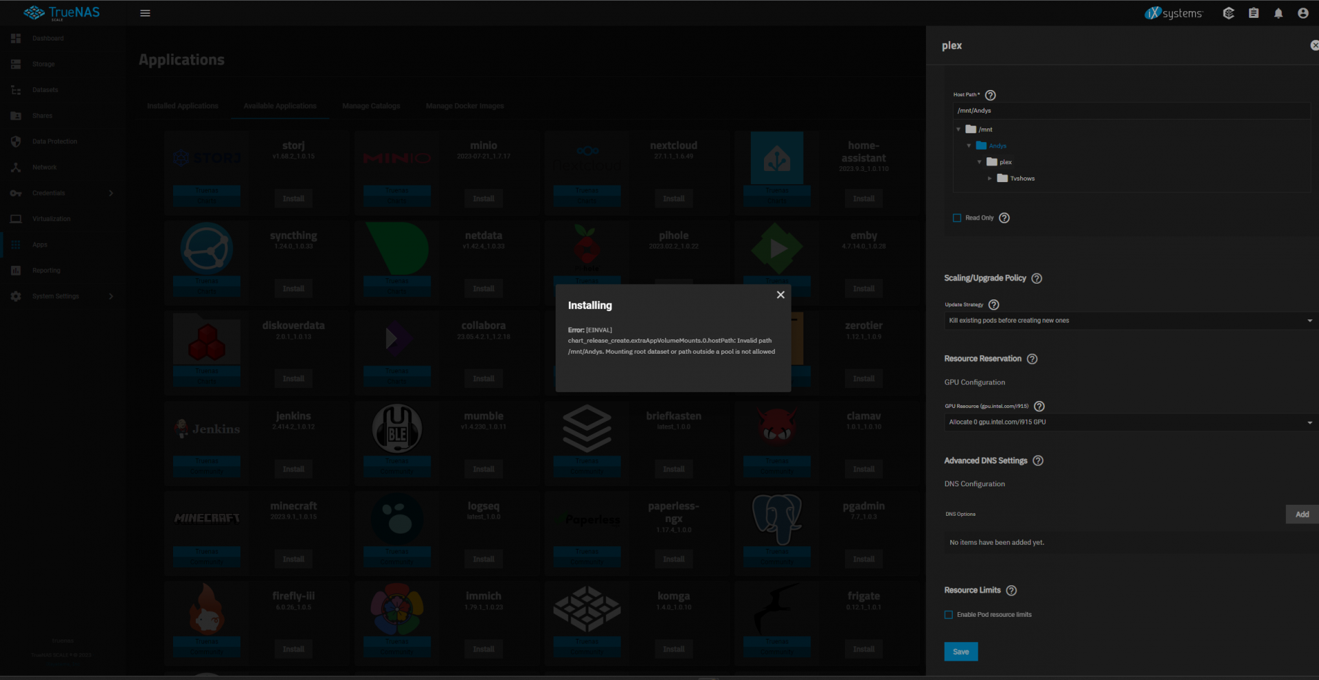

Can some please help me , im trying to add Plex with in TNS but i keep getting this message ,
Iv mapped the drive within windows and can add files/folder to it , but im so confused right now as to why plex will not install.

  6. As for plex - you seem, and its difficult to tell, to be trying to mount the config volume rather than the data volume. I suggest installing plex with all defaults - and make sure it installs first - then change one thing at a time.
