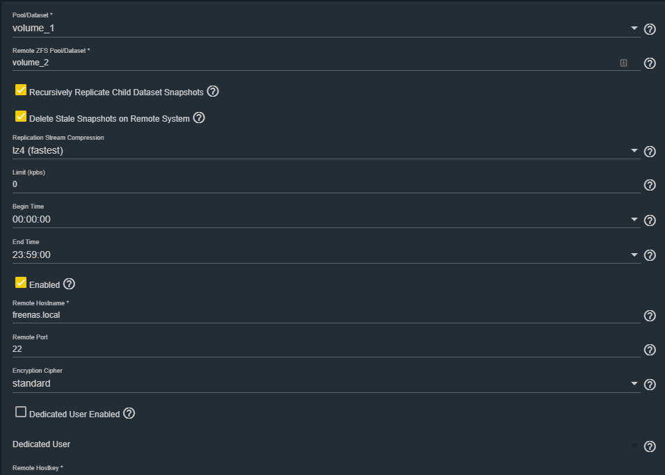

You actually set up remote replication the same exact way you would set up remote replication. The "remote host" in this case would simply be the name or IP address of your local host. Here is a screenshot of how I'm configured. I've left out my SSH key for obvious reasons but when you get to that field, you simply click the "scan ssh key" (assuming you are running 11.1 or 11.2, this button may exist with previous versions but I built my system just before 11.1).
