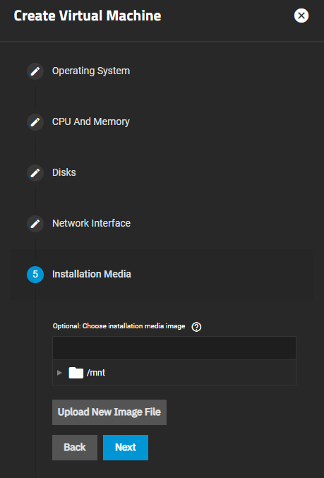

I want to upload another ISO to it, specifically rescuezilla. I can only select the ubuntu install ISO.
How exactly to I upload another ISO to for the virtual machine to use?
Upload new image file

Thank you for the reply.
You are showing the option at the creation of a virtual machine.
The virtual machine has already been installed.
I am NOT doing that again as there is a lot to setup, ran and tested to work as I wish.
I want to upload another ISO, as a means to backup the virtual machine. I may wish to install it elsewhere if there is an issue with the machine.
The is no option for that I am aware of.

I created another virtual machine, with the rescuezilla iso uploaded to it. It will not be turned on.
The ISO is in the same location as the ubuntu install ISO.
I added another CDROM device in the ubuntu VM and chose the rescuezilla ISO.
I could boot from it.

On CORE you copy the ISO to anywhere you want on some pool, the in the VM settings go to "Devices", add another CDROM device and assign the uploaded ISO. Can't you add devices as you need in SCALE?
Apparently only if it has been uploaded already through the GUI when creating a virtual machine.
Attempting to choose an ISO copied to a dataset using cifs/nfs causes errors.
