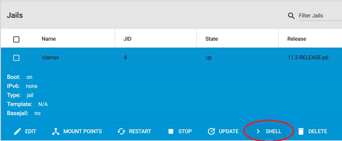

2. If jail wasnt started automatically, Start jail and open shell from within the jail

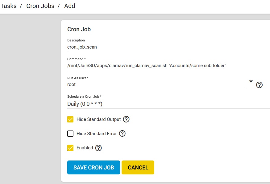

21. The run_clamav_scan.sh script needs to be run on server root level *generally you setup a cron task to kick it off regularly
Cron Task:
22. Thats it!
If you want to kick off the job manually, login as root on the server and do
$/mnt/JailSSD/apps/clamav/run_clamav_scan.sh "scan target folder name"
Cron Task:
22. Thats it!
