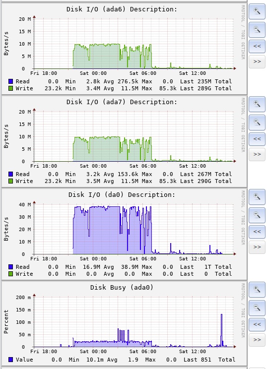

This morning I checked on it and the status was still updating, everything seemed ok. Later I checked again and I noticed that the current filename hadn't changed in a while. While about 1TB has copied over, there's another ~.75TB to go. I found the disks weren't busy anymore, system load was above 1.0, the GUI was sluggish, and there was a python3.6 command using up 100% WCPU.

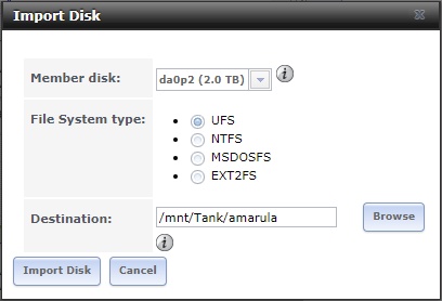

Last night, I started the disk import via the GUI, like this:
