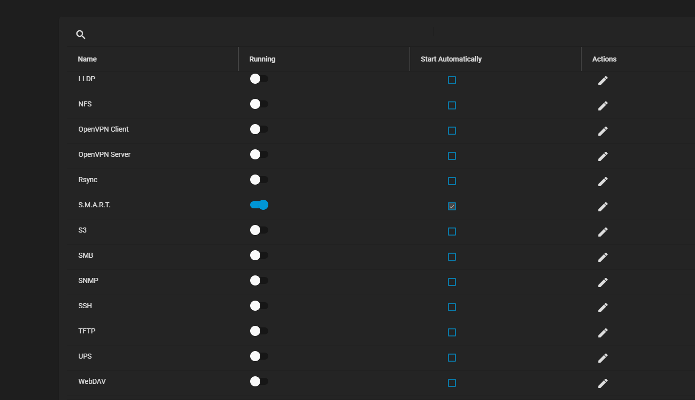

majerus
Dec 21, 2012
126
@morganL Should kubernetes be an option to enable from this screen?
