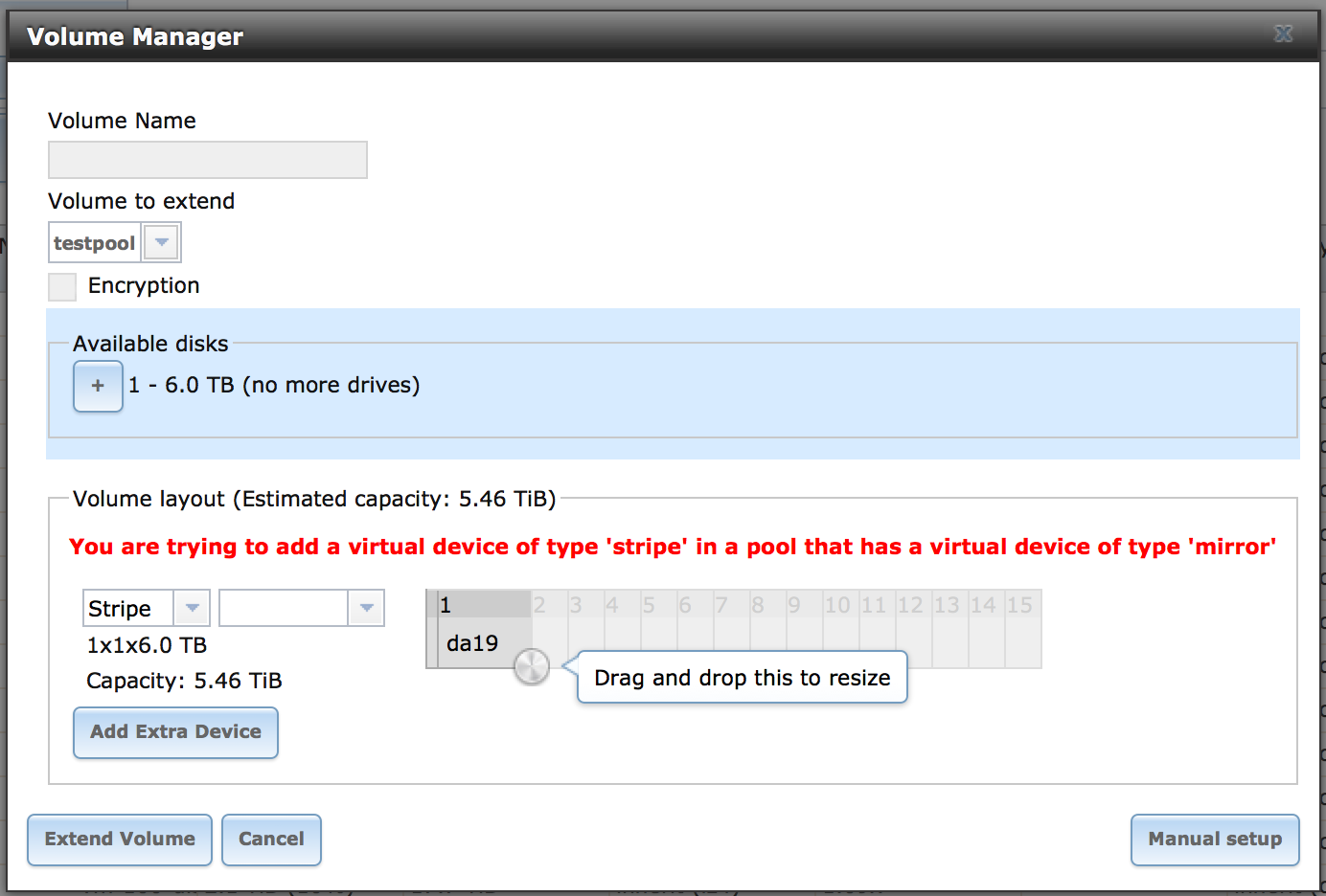

I accidentally added a disk to a zpool the wrong way in the process of replacing a bad disk.
So how exactly did you do that? You blew through a warning that looks like this:
...and then went to Manual setup, and then added the disk. Didn't anything about that suggest that you might be doing it wrong?

@danb35 can I haz bigger picture stating the point a little bit closer to my nose plz? :P :P :P
15,504
Well, the picture size was just what my screen shot did. But I'll admit, the post was a little snarky. At the same time, though, I'm genuinely mystified how people continue to blow through this. We have a good, clear, through manual. It has clear, correct, step-by-step instructions on replacing a disk. Nowhere do those instructions say to go anywhere near the Volume Manager. But people do, over and over again, and ignore the warning that's in bold red print, and then come here asking how to fix it. I just don't get it.
