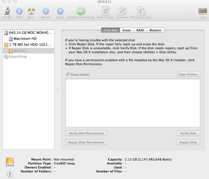

This is what i see when i plug the disk into my mac and checked it out in disk utility. It could not recognise the format as it is still some sort of freenas format (UFS) but still freenas can't see it unless you want to add another disk. Should I try selecting the disk as a new one or will it delete everything for good? It will reformat it won't it.. Dame I want my files back...

What you're seeing on your Mac is the swap partition at the beginning of the drive, the data partition should be after that. Since you're speaking of a single drive connected to your Mac, I'm assuming you are having trouble with the single 1TB disk, is that correct?
