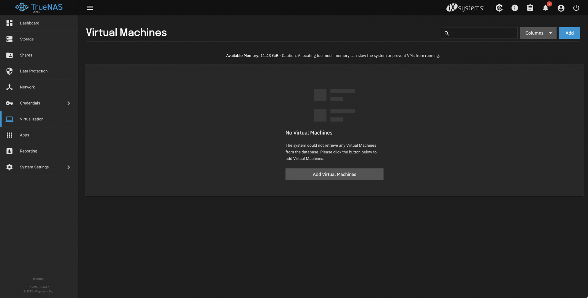

Hi All,
I had accidentally deleted Docker under "Virtualization" on TrueNas Scale, is there a way to manually get it back back?
The reason I had deleted it - I have a separate zpool for virtualization that was giving me kernel panics during zpool imports, so I had removed the disks in that pool and removed docker under virtualization ....
simdim
Mar 12, 2019
75
To clarify where is official Docker image that I can reinstall?
I think that is the reason I am getting [EFAULT] Kubernetes service is not running. error when attempting to install applications
simdim
Mar 12, 2019
75
Ok. Baby steps. Downgraded/upgraded got Docker VM back. Since I had to destroy the pool that docker was mapped to I no longer have /mnt/pool/Docker_Docker directory to mount RAW disk. Created directory as root and getting "/mnt/pool/Docker_Docker': Permission denied" on Docker start
What ownership/permissions do I need to have on it?

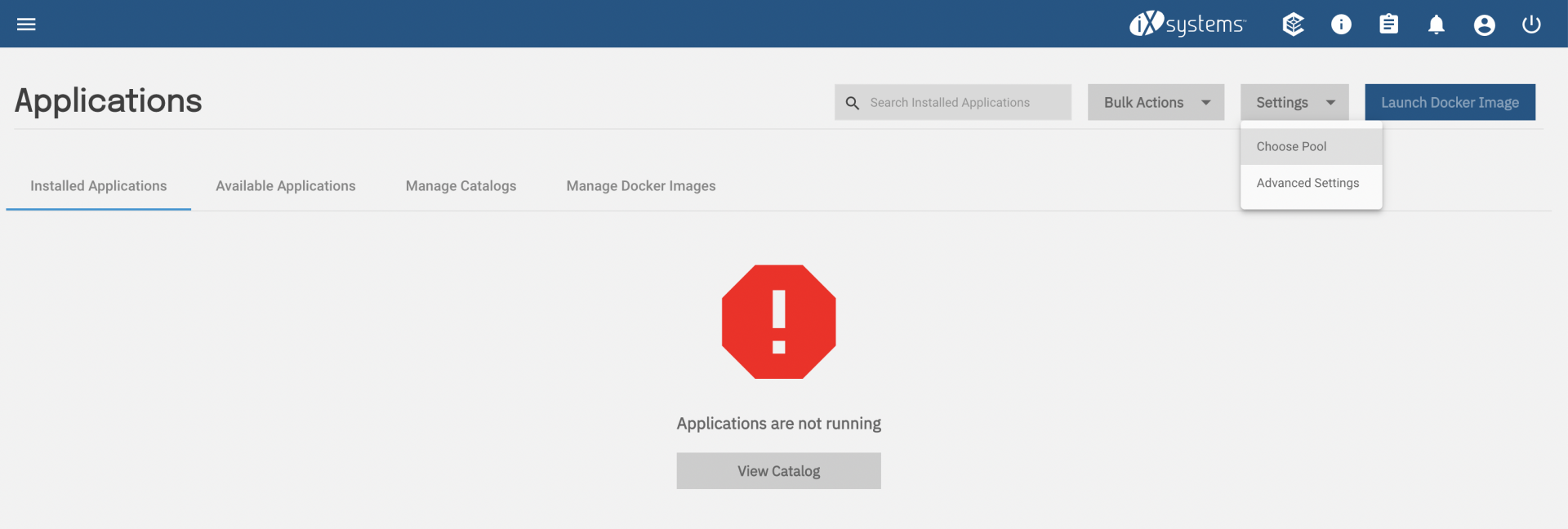

On closer examination k3s cluster is not coming up though it is giving me :
Failed to configure kubernetes cluster for Applications: Missing "pool/ix-applications/docker, pool/ix-applications/releases, pool/ix-applications/k3s" dataset(s) required for starting kubernetes.​
All I see there:
root@freenas[/mnt/pool/ix-applications]# ls -l
total 1
drwxr-xr-x 5 root root 5 Aug 24 11:31 k3s
15,504
I don't know what "clicking on it does not bring up selection", but what happens if you click on Unset Pool, and then go to Choose Pool? It may be that the system has the old pool stuck somewhere.
simdim
Mar 12, 2019
75
"Unset" option is not present every time I click on "Settings" and even when it is present it does not open a dialog. Clicking on Advanced does not open dialog ether.
15,504
15,504
currently I do not have "Unset pool" menu entry under Apps>Settings
...then go to a place where you do have it--Available Applications would be such a place. Then select it. Then see if "Choose Pool" is no longer grayed-out. If it isn't, try clicking it then.
simdim
Mar 12, 2019
75
That had done the trick - under "Available Applications" I was able to Unset the pool and set the new one.
k3s service came up and I was able to deploy app from catalogue.
Thank you very much for the help!
