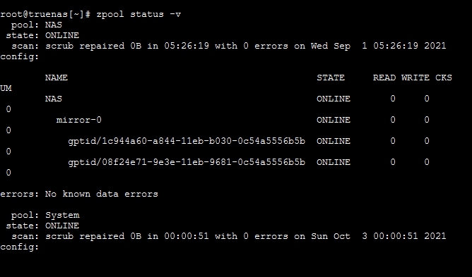

Could the OP please share the output from zpool status -v on that pool?

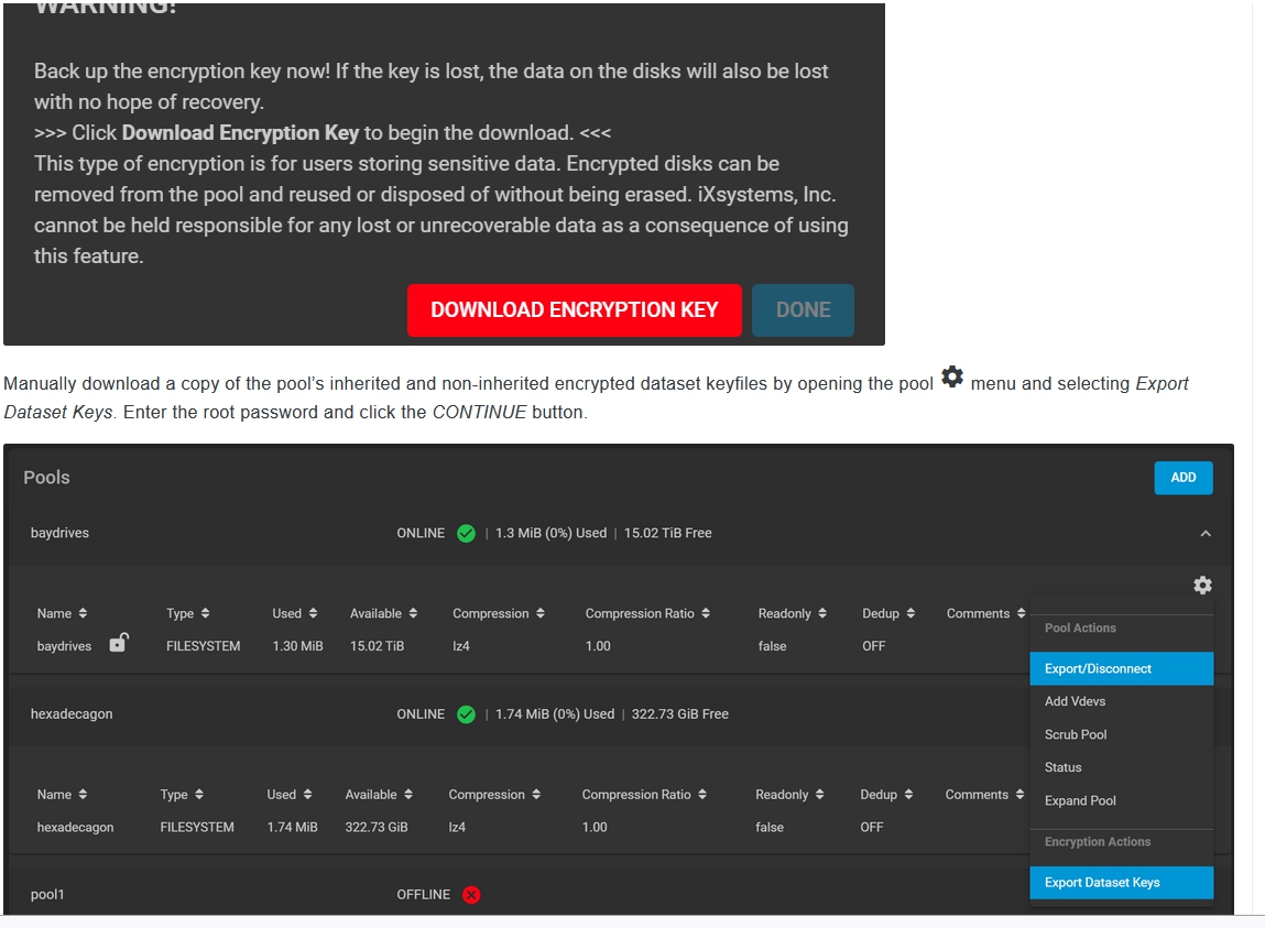

As noted by sretalla, the options given in the lower part of this illustration are in fact missing:
There is no "Export Dataset Keys" option. That would solve the problem if it was like the manual says it is.

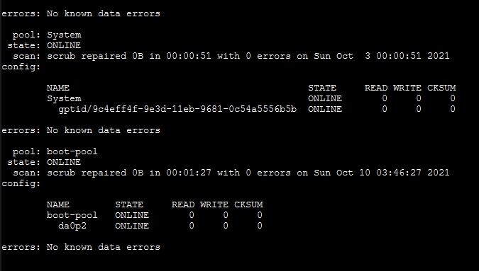

I hope this is the information you asked for: I'm a total noob when it comes to CLI work.
There are just two pools: NAS and system, relating to the HDDs and the SSD respectively.

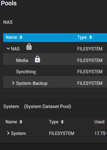

Your pool isn't encrypted with GELI, as none of the members have an .eli suffix. Does your pool exhibit a lock in the GUI?
NumberSix
Apr 9, 2021
188
Yes. I encrypted a dataset in the NAS pool when I created it>
9,703
Did you select the encrypt with passphrase option? in that case I don't think you get an option to download keys as your passphrase is already effectively the key.
