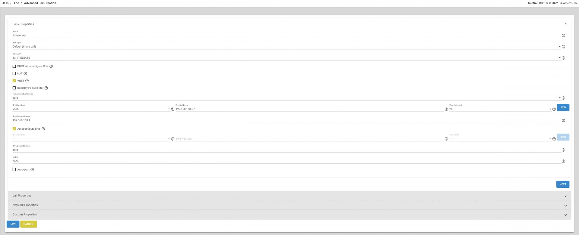

<JAIL_NAME> with the name you want the iocage jail to have (I have used 'limesurvey')
<JAIL_IP> with the IP address you want the jail to have, within a useable range
<IPV4_DEFAULT_GATEWAY> with the value in Network > Global Configuration
