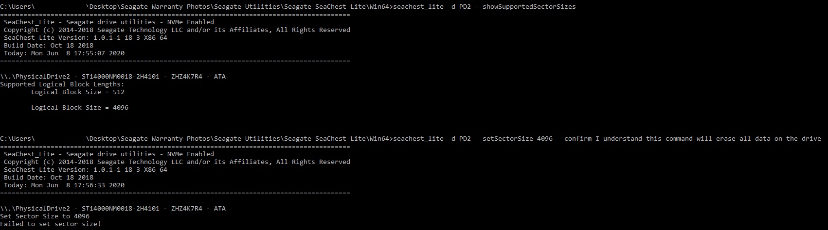

First, I want to thank you, ixion. There is next to no documentation on the "How", just that it can be done. You sent me down the right path. I followed the first two steps (Scan & Show Sectors). But i'm having trouble with the last step. It won't set the sectors as you can see below. I'm using Windows 10 and Seagate Exos X14 Drives and the data sheet says it can handle 4k. I've tried as direct SATA connection and as an USB external drive. I'm banging my head against a wall. Any help would be appreciated! Thanks in advance.

Is this one of those utilities that absolutely have to be run from MS-DOS?
Jimi Evo
Jun 8, 2020
3
Maybe. I'm running from command prompt (Run; CMD) Would you think a bootable drive is the way to go?
Samuel Tai
Apr 24, 2020
5,399
According to the SeaChest manual, it has to be run from an Administrator Command Prompt.

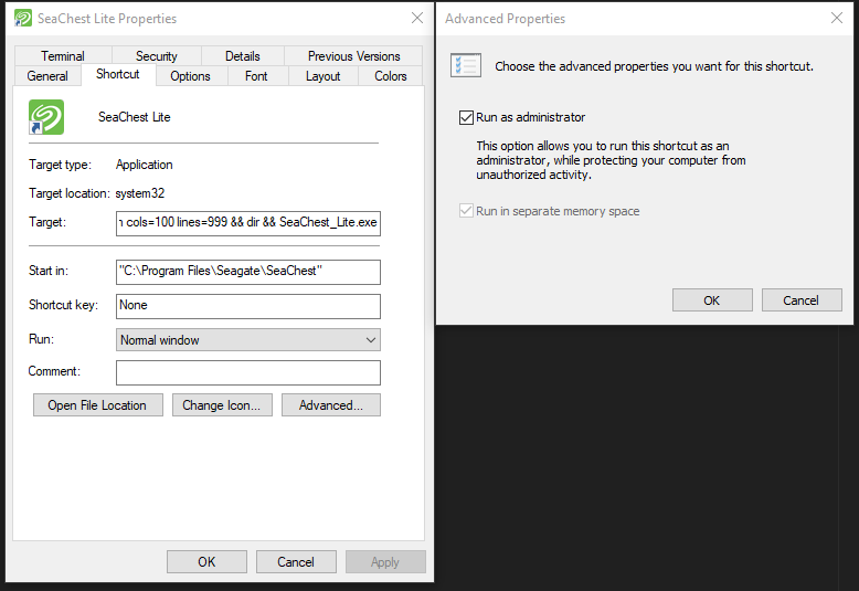

@Samuel Tai , I believe I am, See attached photo. I could be wrong.
