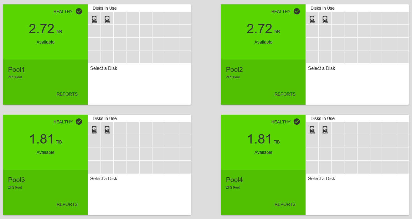

Also, why do you have 4 pools with 2 drives each?!

I think you have this setup wrong. All those drives should be in one pool together

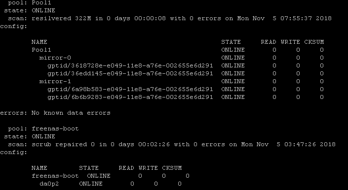

As of now, it has run without an issue on the 4 (3TB) drives setup as 2 mirrors for over a week.. (I think I answered my own question regrading the setup of these.)
Previously I had this setup with 6 drives in a Raid6 configuration... I think :)
Current:

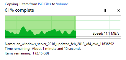

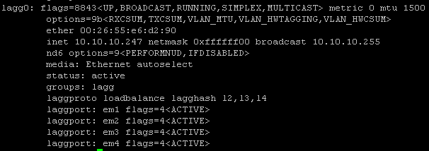

Again, I want this storage for Hyper-V Guests connected via iSCSI. I hope to try to do some bench marking soon, because whenever I copy a large semi-large file... the speed is a joke. Again, I need to find a common denominator for that. I really don't think it's network related because the Freenas is setup with 4 NICS in a LAGG:
And the system doing the copy has got 3 NICS Teamed.
Here is any idea of the flaky copying:
Pretty lame, huh?

Based on the image in your first post, I am not sure what you are talking about. It looks like you created four separate pools with two disks in each and that is NOT a desirable configuration for any reason.
That is actually going to make things worse unless you have proper network configuration attached to it.
We need to know what kind of client you have also as well as what switch you are using.

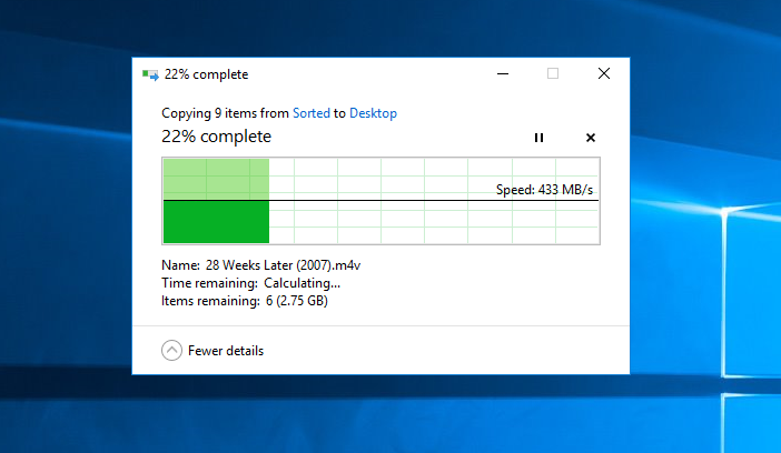

If you get your configuration right, you could get speeds like this:
