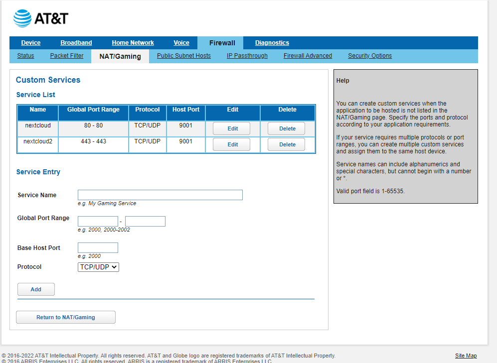

Hello,
I have installed TrueNas Scale and installed nextcloud running on port 9001
I have purchased a dns and setup a reord
I have setup port forwarding 80 and 443 to my truenas scale machine.
when accessing it from internet it is sending me to true nas scale login page not on the nextcloud running on port 9001
how to fix this so when i access from internet it goes to my next cloud not the truenas scale?
can anyone help please thanks.
15,504
Maybe forward those ports to 9001 rather than to 80/443?
kashifqazi
Jul 24, 2022
9
I setup the port forwarding but still not able to access nextcloud on true nas scale.
can you please help what is the problems

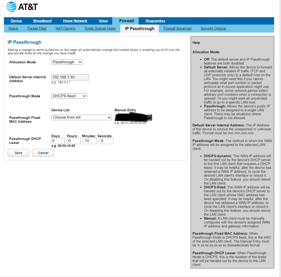

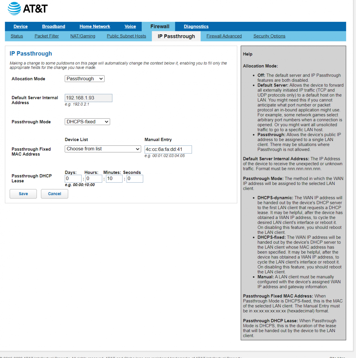

Samuel Tai
Apr 24, 2020
5,399
You didn't actually create a passthrough to your NextCloud; you created an open port 9001 to your router. Delete those NAT entries and try setting it up under IP Passthrough.
kashifqazi
Jul 24, 2022
9
Setup the IP pass through but it is also no working.
I'm only able to acces truenas through internet when i add port forwarding.
Not able to acess nextcloud through internet.
can you please help what is the issue.
