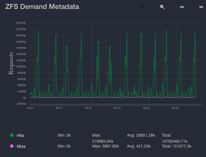

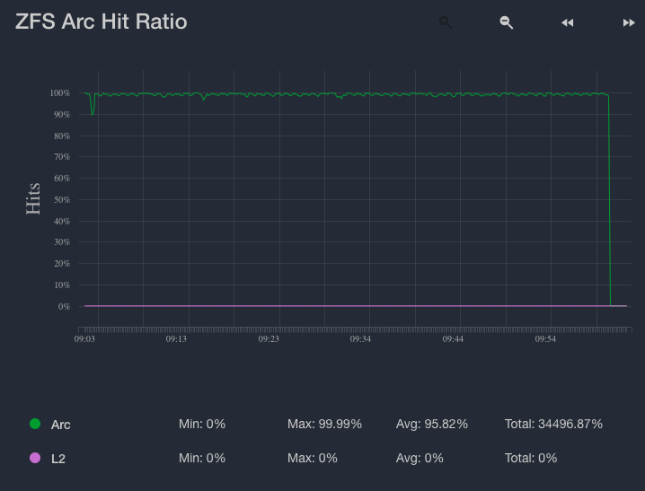

OK, so it would appear the best course of action would be to increase my RAM to 128GB, and watch my ARC hit ratios to see if they fall below 90% (meaning that more and more of my data is not being served from ARC). I don't mind throwing in the Intel and it has a 35PBW life (and it's never been used) so it would take years for me to use up that endurance, but from what you guys are telling me it would be a waste to use even if my ARC hit % was low just due to its large size, correct?
Is there any downside to throwing in the 500GB NVMe as L2ARC which I have the system down for upgrade as opposed to having to take it back down in the future if I decide I actually need it? Right now, it looks like I am almost 100% ARC hits and this is with 64GB RAM currently:

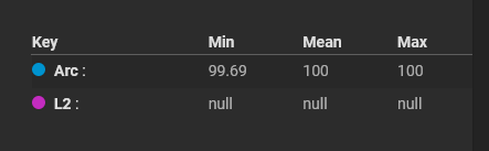

Dec 29, 2014
1,135
This isn't an exact parallel, but I have 256G of RAM in my E5-2637 V4 system and there are just short of 20 VM's (on separate ESXi server) on this NFS pool and this is what my ARC stats look like. I have an Optane SLOG and I debated using some of that for L2ARC, but I can't see a reason to do it.
