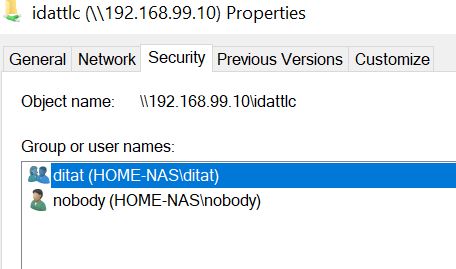

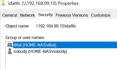

Ok, I'm totally confused with SMB share now. My config listed in other topic: https://forums.freenas.org/index.php?threads/delete-the-everyone-share-permission-smb.55629/
Point is - no "anonymous" access. I did slightly modify user structure, changed to nobody and use group as in video tutorial.
Problem: I DID NOT login to my share and yet I do have access. I'm not in a group and not using same user on windows. I even deleted "Everyone" ACL using same windows client machine. Now I see this under "Security" and yet I'm able to access share and write files :( Same from other windows machine. What am I doing wrong?

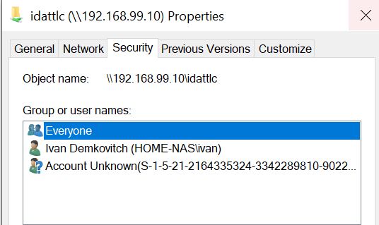

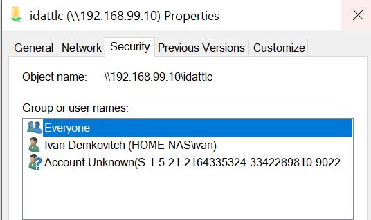

7. Windows security property, now it can't lookup group for some reason
Any ideas why it still let's me browse/edit? And why it keeps setting "Everyone" permission? And also this permission only "Read" - it allows editing.
The dataset is owned by "ivan", you are authenticated as "ivan", ergo you can access the dataset. Default permissions on a newly-minted dataset are:
 owner@:rwxpDdaARWcCos:fd-----:allow
  group@:rwxpDdaARWcCos:fd-----:allow
  everyone@:r-x---a-R-c---:fd-----:allow
What you are describing is normal behavior. Remove the everyone@ ACE and people who aren't the "ivan" or a member of "secret" will not be able to access the share. If File Explorer is causing problems, you can remove it via the following command: setfacl -x everyone@::allow /mnt/main-4TB-mirror/IDATTLC

You can remove the everyone ACE from your share using File Explorer or the CLI
Now I have another question. "Everyone" means everyone should see/browse files. But it's not the case now. The way it seems to be working now - I'm OK with it. But, why doesn't it let me browse anonymous, I'm "everyone" by default, no? Guest access disabled right now, I'm just trying to understand what this "everyone" permission does right now and if there any security risk?
