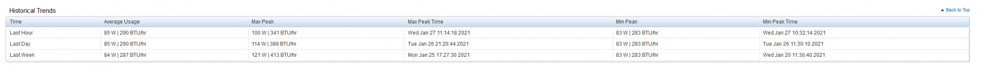

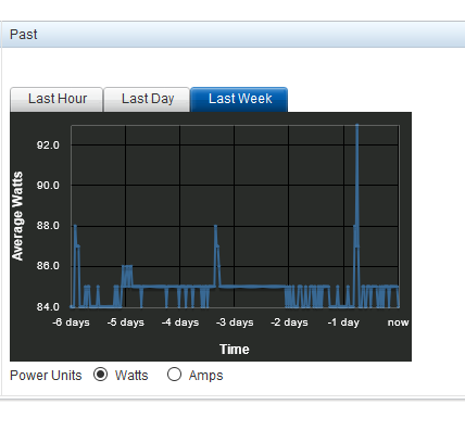

It's been about a month and no issues with temps or power. Here are the power trends from last week according to the iDRAC:
