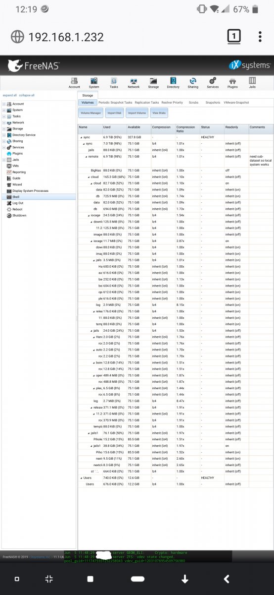

I ask because, looking at the remote file system, it seems everything is nested within itself. See the screenshot I attached. If I explore the file system via ssh, I see the same thing: /mnt/Remote_Pool/remote/iocage/iocage. This doesn't look right to me. When I re-build this backup, how should I set up the child snapshot/replications to avoid this?

Will you please provide a better quality screenshot?

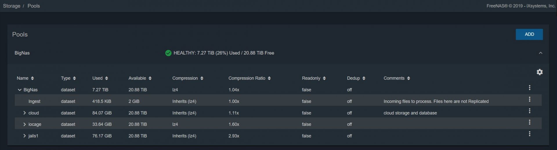

  • I have 4 sub-datasets: warden Jails, IOCage jails, a dataset for my Nextcloud instance, and an 'ingest' dataset that I don't want to replicate (I may do a lot of renaming/sorting, and may not even keep a lot of files that end up there):

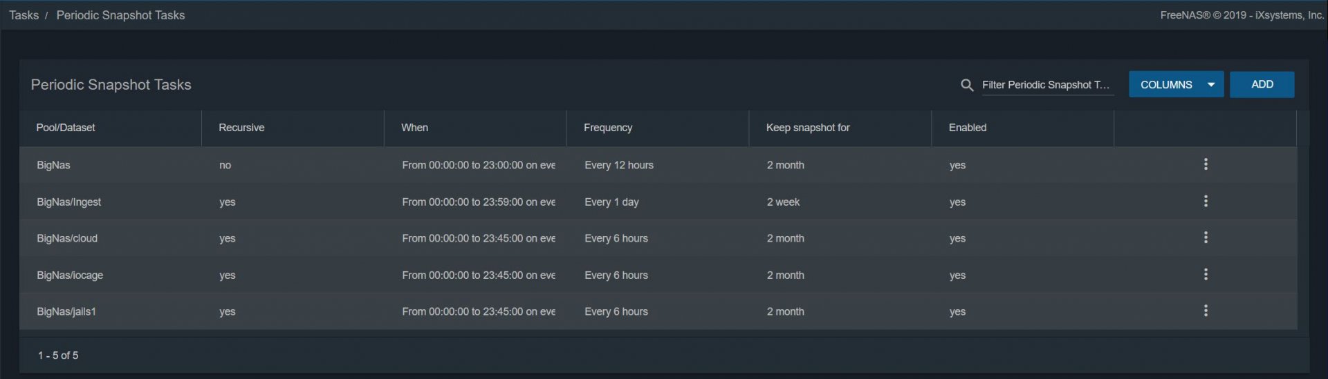

  • I set up Individual snapshots at different intervals for the main pool (non-recursive), and all 4 sub-datasets (recursive):

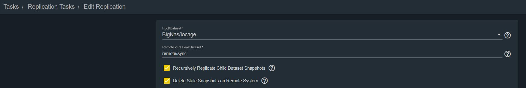

  • I now replicate all snapshots (except the 'ingest' dataset) to my other server. ALL tasks replicate to the same pool/dataset (in the case of my remote server, it is remote/sync [the dataset sync in pool remote]):

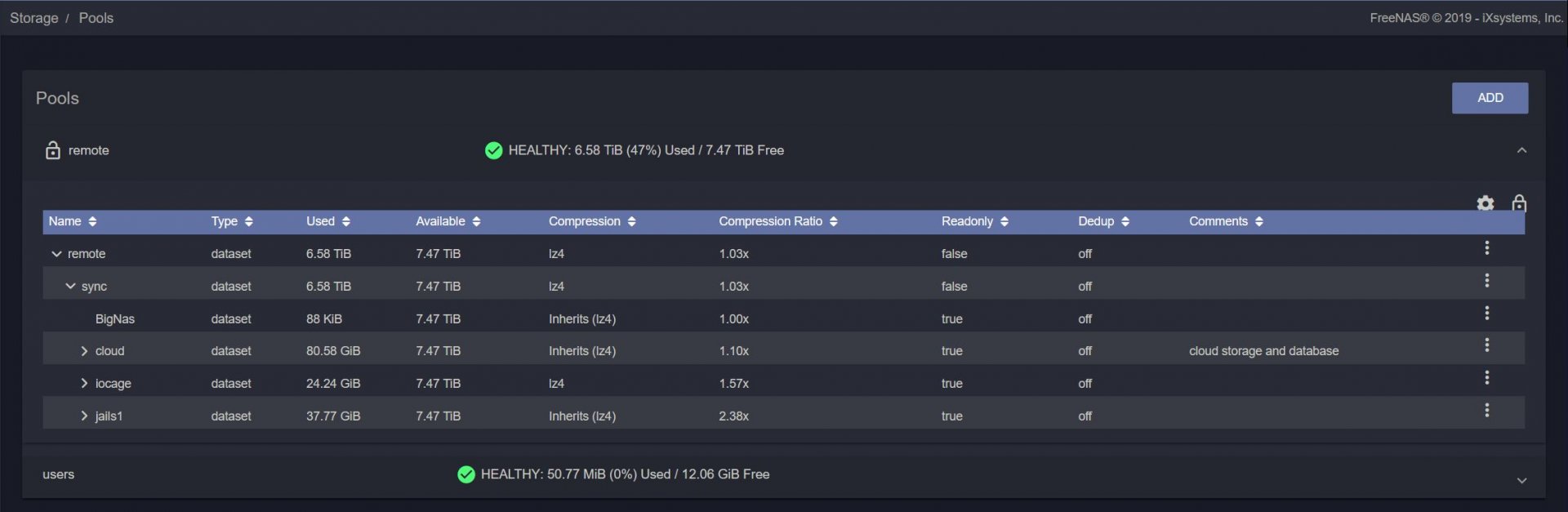

The data pool on my other NAS looks like this:
At first I was worried by the 'BigNas' dataset listed under sync, but if you look, it only takes up 88kb, whereas the actual dataset sync is over 6TB.

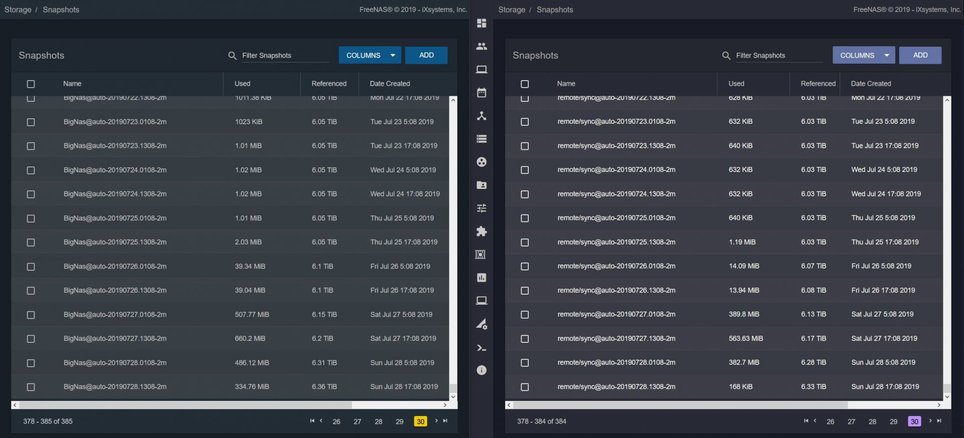

If I go into the list of snapshots on the remote server, all of the snapshots for BigNas have been changed to remote/sync:
