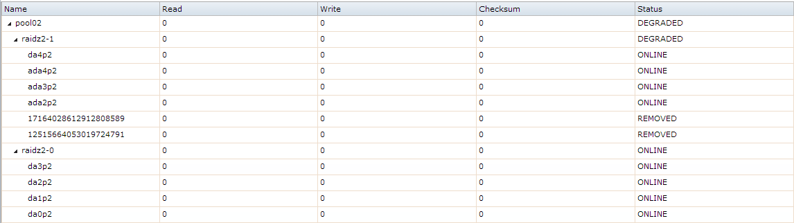

Thanks for the responses, it appears i actually might have an issue on my hands so clearing the error isn't the right thing to do at this point. I just shut down my box because i keep getting the following issue.
Basically, i don't have any issues and then a few hours after the server boots up i get this critical error. It goes away after i reboot but then comes back again. Do i need to replace the drives already or does anyone have a good idea on what is causing this? Screen shot below -
@gpsguy, how do i do that?
warri
Jun 6, 2011
1,193
It looks like two of your drives keep dropping out. That's a bad sign, especially because it leaves you without redundancy. So you need to find out why this happens:
- Post the output of "zpool status" here.
- Have a look into the system log (issue "dmesg" in the shell, or look into the .system dataset if you are running a 9.2.1.x version) and see if you see some errors about the disks. Alternatively just attach the whole log here for us to have a look.
- Check the smart values of the disk: Issue "smartctl -a -q noserial /dev/adaX" for each of the two affected drives, find out the number (X) by looking into the status just after the NAS was started. Also post the information here.
Then we need to know which version of FreeNAS you are running and on which version you created the pool? Looks like its not using GUIDs for the disks, which have been introduced somewhere in 8.0.x or 8.1 I think.
Regarding the output: You can log into your server via SSH and issue the commands there (or use the Web Shell). Then copy the output (Web Shell might destroy the formatting, though), and put it between [code][/code]- Tags.

Sorry gang, just got home from a long one. Here are some deets:
  • FreeNAS-9.2.1.3-RELEASE-x64
  • Using 10 hard drives with 2 RaidZ2 vDevs: 4X3tb RaidZ2, 6X3tb RaidZ2
    • 5 drives are connected to SATA motherboard ports, 5 drives are connected via an IBM M1015
    • 4 or 5 of the drives are WD Reds and the others are desktop 3tb drives (i know i need to swap these out sooner rather then later)
  • I just upgraded from 8.3.1
  • I also just redid my volume by backing up all essential data, erasing the old volume, and creating a new one (wanted to take everything from RaidZ1 to RaidZ2). I can't remember if i created the new pool/volume before or after the update
  • Only thing hooked via USB is a UPS (my driver wasn't listed so i picked the next closest, i have an open thread asking what others did for this model), and an apple keyboard
  • Attached all the files @warri asked for, i wasn't sure exactly which drives were the problems in the vDev so i did a SMART output for each.
Thank you all for the help and specific instructions on how to get the necessary data to you all.

Here's my review of all that stuff:
zpool status shows 2 drives with CHKSUM errors. That's not a good thing(obviously).
Drive 1 has some Current_Pending_Sector errors. Offline_Uncorrectable is also 8. That drive has problems. If you do a SMART long test it will fail. At that point it will qualify for an RMA if in warranty. That's the only drive showing any problems. If that disk is attached to a SATA controller that happens to have whatever other disk has those CHKSUM errors, the controller may not like the errors. This may mean that the controller can't handle errors from one disk without affecting other disks. If this is the case, it may be a bad choice for a server. If it's the M1015 it could be something else(probably user error related such as a bad firmware match for the driver or setting change). I know the M1015 can handle disk problems without problem(unless you want to believe you are the first one to ever have this problem on the forums which I dismiss as unlikely).
Overall, I'd replace "Drive 1" and see what happens. I'd do that sooner than later too since your vdev may be having problems.
Noteworthy but unrelated is your hard drive temps. For drives that are probably near-idle those temps are a little high. Almost certainly they go over the famed 40C line(which is where drive life can be shortened). Not necessarily a bad thing, but if you can increase the cooling I'd absolutely od that.

Clinderw
Aug 11, 2013
96
I replaced the hard drive on Friday and everything seems to be running as usual again. I do have two follow up questions -
  1. When i run Zpool clear it essentially says it needs more information then just typing 'zpool clear' in the CMD line. What is the proper script to run?
  2. The second hard drive that was throwing issues before still has a CKSUM value of 42. Is that something to be concerned about?
Thanks,
Chris
warri
Jun 6, 2011
1,193
1. zpool clear <poolname>
2. No indications of failure in the smart tests and logs? If you find something, replace the disk. If not, clear the pool and scrub the volume to see if the checksum errors persist.
EDIT: Oh wait, by replacing one drive and resilvering the volume, a scrub was already performed. If the number of checksum errors didn't increase, you are good to clear for now without scrubbing.
Clinderw
Aug 11, 2013
96
Great - just cleared it.
Everything is back to operational / green.
