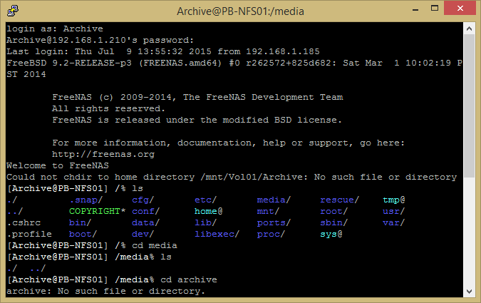

I can't even access the directory I need to get into.

Your media directory doesn't have anything in it. That's what ls shows you
pirateghost
Unintelligible Geek
Feb 29, 2012
4,219
If it is mounted at /media you have a bigger problem. Default mount point on FreeNAS is /mnt
Why are you logging in as Archive?
Oh boy this is going to be rough....

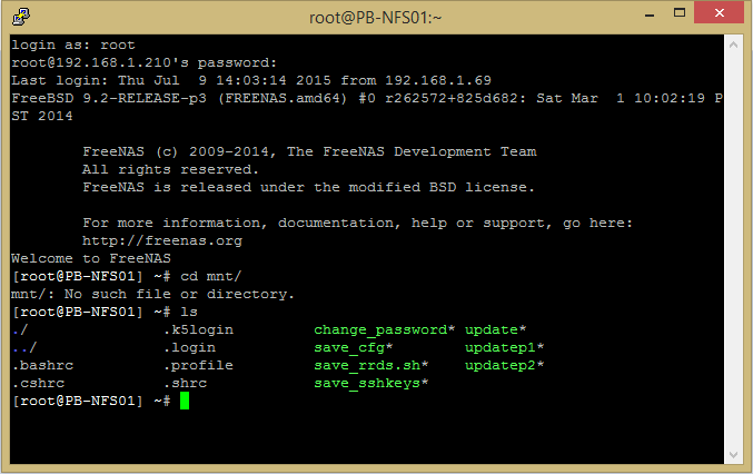

Well when I try to get to the media folder or the mnt as the root user I can't get to it.

Because you are typing the wrong path.
It's /mnt
You are not in / by default which means mnt doesn't exist in the directory you are in.....
Please take a minute to understand what you are doing. You are about to do a whole lot of irreversible damage..
