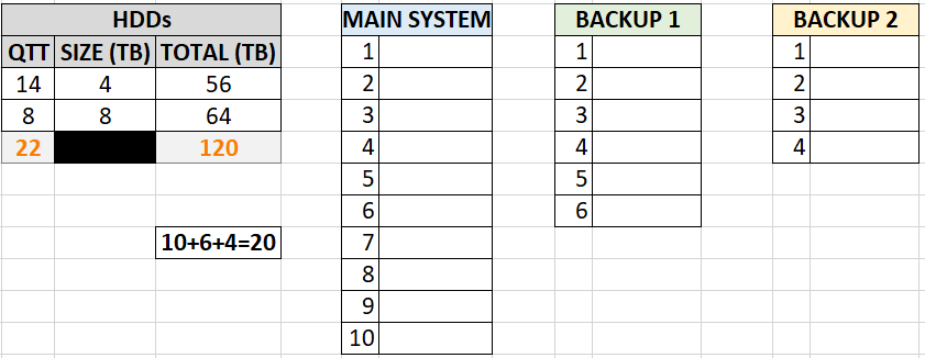

So I reached a point where I have a bunch of HDDs and I'm wondering what would be the best way to arrange them, both physically (where/which size) and logically (zfs-1,2,3, mirror vdevs etc).
That's my situation:
So, my challenge is: how to distribute this bunch of HDDs among my systems, so that I maximize space with good redundancy/security, and keeping at least 2 backups.
The MAIN SYSTEM has 10 slots, the BACKUP 1 has 6 and the BACKUP 2 has 4. Of course that the first approach is to allocate the larger disks in the smallest systems and vice-versa, but how?
Currently my RAW data size is around 22TB.
Thanks for any advices.
Regards.

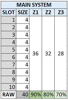

Are you going to use transaction heavy workloads or is this mostly data at rest?
The main system has got the most slots and more spindles/vdevs gives more IOPs so I would fill it completely with the 4 T drives. Then it depends on your workload if you go
  • 2x 5 disk RAIDZ2
  • 1x 10 disk RAIDZ3
The first will perform a bit better. Mirrors seem to be out of the game because of your storage needs. The 24 T the first option gives you might even be too little depending on what you mean by "raw data size" ... ZFS raw or used by files?

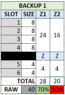

Your options are a little limited. Backup 2, assuming it can be okay to have a risk of dying because backup, can't go beyond 24TB (4x8TB raidz1).
Backup 1 could have 28TB but that seems not that useful, so maybe 24TB (4x8TB raidz1) as well.

I dare to say that my concerns with performance are NONE. Seriously. This is a home system, I'm the only user, and all it has is my Plex data (movies, music and TV shows), and some personal files, but nothing that I can't download again or that are not backed up in cloud providers (Google, Microsoft, Dropbox etc).
Sorry for the confusion: currently, my allocated data size, as displayed by FreeNAS, is 16.41TiB. The pool total size is 21TiB.
In my tables I'm using the rounded numbers to make the math easy. No problems.
I guess that the BACKUP 2 is the easiest: there's nothing better than Z1, unless I take the risk to use it as a JBOD:
Regarding the MAIN SYSTEM, it's more complicated, specially if I try to accommodate the BACKUP 1 also.
If I put all 10x4TB in the MAIN SYSTEM, I'll be left with only 4x4TB disks. So I'll need to put the other 8TB somewhere. The problem is that this "break" the arrangements, in such a way that I'll need to use mirror vdevs or work with 2 pools in one system or another, or both.
Here are some scenarios that I'm considering:

I would go Z3 with the main system and 4x 8 Z1 for both backups and not worry about the "wasted" slots.

Thank you for clarifying.
So with 16TiB now, you can reasonably do 10-wide raidz2 with 4TB drives in main, giving you 26.7 TiB or so usable, or do raidz3 for more resilience in main, for 23.4 TiB usable. Given that you want to stay within 80%, that's 2-3 years of growth for raidz3 and 4-5 years of growth for raidz2.
Then do 4x8TB raidz1 plus 2x4TB mirror in backup 1, and 4x8TB raidz1 in backup 2. That's 20.4 TiB in backup 2 and 23.9 TiB in backup 1.
