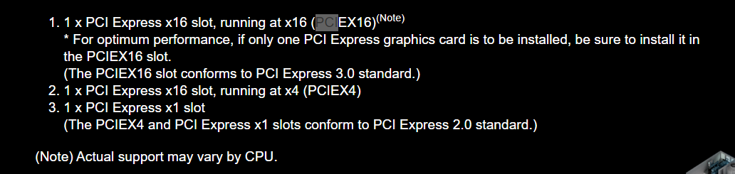

  1. Is the LSI SAS ok in the x16pci slot, all reading I've done suggests thats fine, Guessing anyfirmware updates would need to be done from windows?
  2. TrueNAS Core or TrueNAS Scale, The scale seems to offer a fuller linux, and could run VMs
  3. Any other advice?
CAH1982
Oct 27, 2022
4
Just been offered the bellow as well
Gigabyte B450M DS3H
CPU AMD Ryzen 3100
Geforce 710grx < Would probs have to be removed once installed to make way for the lSI SAS, or could this be used in other port at x4? would there be an noticable difference
