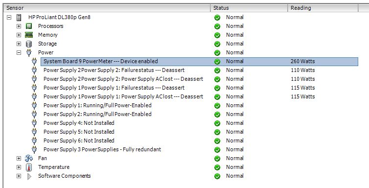

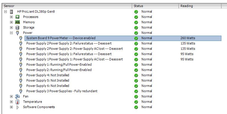

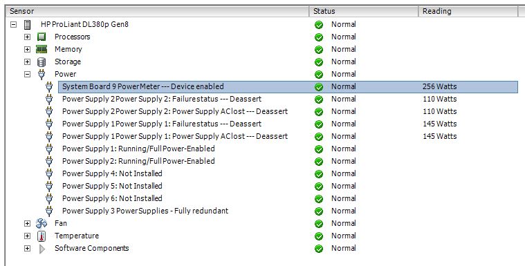

not 100% sure what the G8 pulls when chugging along.
I've got three HP DL380p Gen8 servers in production, albeit slightly different config. These servers have dual E5-2697 v2 and 256GB of RAM, 4 Intel X520-DA2 dual port 10Gbe cards. They run between 210 - 280 watts depending on load. I would imagine your server would pull a bit more power as you're running more on-board storage. My three use a Nimble SAN for storage so they only have 3 x 300GB 10K SAS for local boot volume.
