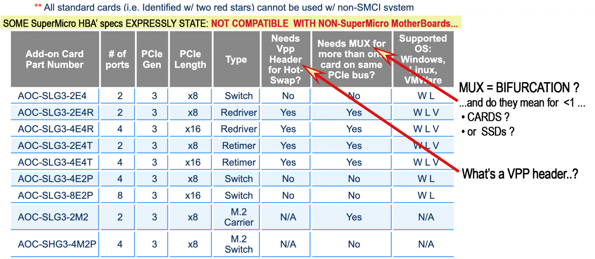

  • I'm unclear if you were saying (since I mentioned having a GigaByte MB) the SM 4E4R will work with 3rd party MotherBoards..?

SuperMicro's HBA product page for above HBAs: Some only work with validated SuperMicro server systems & MBs.
They ALL refer to the validated platforms list: Neither AOC-SLG3-4E4T nor AOC-SLG3-4E4R reference any hardware other than SuperMicro.
Ironically, found a reply... specifically about -- HighPoint SSD7120: With but one poignant remark:
"...the SSD7120 works in HBA mode by default" Which may ultimately have answered my question.
Though, it'd be nice if someone could decode the PDF HighPoint sent re: FreeBSD...
  • SuperMicro HBA : RAID controllers.png

I took a look at the original post\pdf and if you look at step #5 you see that card is identified as a PLX PCIe switch, which carves up the PCIe lanes from the 16x slot into four 4x connections. Then they just use gstripe or gmirror to make your array, so there's no real dumbing down of the card, it's just a PCIe switch!
The High-Point gets you around the problem you might run into with PCIe bifurcation. Outside of any other problem where the Supermicro card wouldn't work, you also need the motherboard to be able to slice the 16x slot up into the four 4x connections your drives need. The Supermicro systems I'm using do this, your Gigabyte might not. That's what I expect they mean by MUX in the second .pdf file.
That said, if you have the High Point and it works in your system right now it might not be worth messing with. Particularly because you aren't in them for much more than the Supermicro cards would cost. Looking into what the High-points actually are (PLX switches) I think you have a surprisingly elegant solution that should work well.
