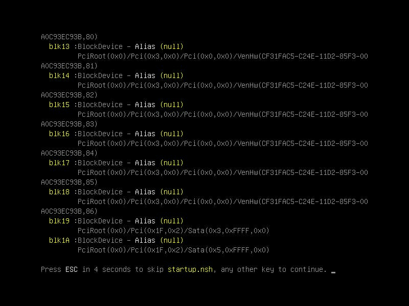

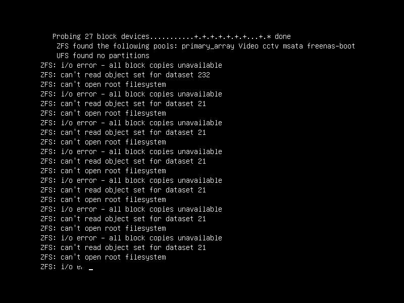

Oh my days. Now it won't even boot. Before you ask - not this is not a USB drive, freenas-boot is a mirrored pair of internal SSDs wired direct to the motherboard SATA headers.
seb101
Jun 29, 2019
142
Well my next step was going to be to re-install TrueNAS from scratch. So I guess this just accelerated that next step...
