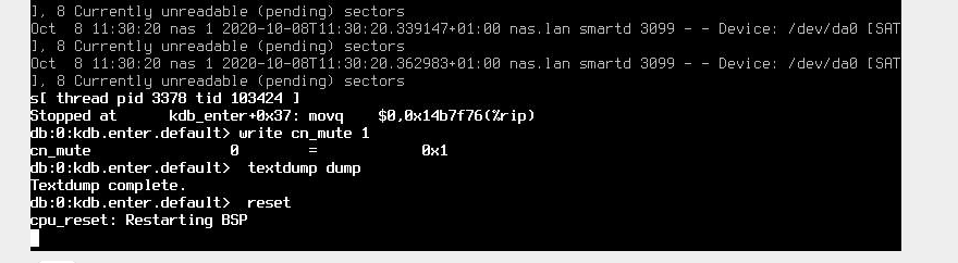

I managed to grab this screenshot from the console when it happened yesterday...

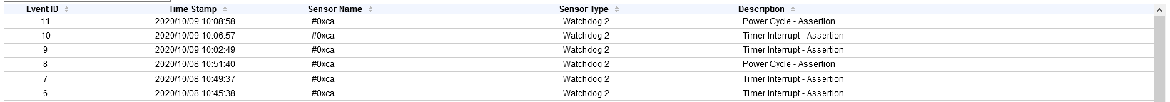

From the Supermicro IPMI... the hangs appear to conincide with with the 'Timer Interrupt' messages... what could cause this?
EDIT: So this is the IPMI reporting that the host OS has hung (did not respond within the timeout period). I do not have my watchdog set to auto-reboot the system, so it just stays hung. Still no closer to finding out why it's hanging.

Your system disk has got unreadable sectors. Since it seems to be /dev/da0 - is it a USB thumbdrive?
seb101
Jun 29, 2019
142
Hi Patrick. That is not correct. The 'unreadable sectors' are on a data pool disk and have been there for a long time. My system disks are two mirrored SSDs on /dev/ada0 and /dev/ada1

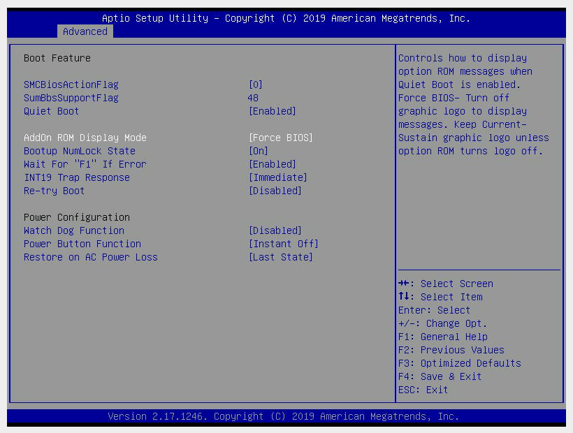

Make sure all settings to do with watchdog timer are off/disabled in the Supermicro bios. The watchdog function does not work with FreeBSD. Also make sure memory scrub is disabled.
seb101
Jun 29, 2019
142
Can confirm the watchdog is disabled. Not sure what you mean about disabling memory scrub? Where is that option, BIOS or TrueNAS?

OK. So it turns out the SuperMicro boards have TWO watchdogs (which makes sense now why it's called 'Watchdog 2' in the IPMI log). Watchdog 1 is a hardware device controlled by the BIOS, but Watchdog 2 is a feature of the IPMI BMC and made available to the OS through the IPMI interface - it is seemingly not possible to 'hard' disable the IPMI watchdog (no option exists in the config), all source material online suggests that to 'disable it' you simply don't load the kernel module for the IPMI interface, or don't start the Watchdog service.
I can confirm now, that the 2nd Watchdog is indeed being recognised by TrueNAS. Running the command ipmitool mc watchdog get

There is a jumper on the motherboard to disable the watchdog.
seb101
Jun 29, 2019
142
Thanks for your continued help. The jumper on the motherboard controls the same Watchdog as the BIOS control (Watchdog 1). It does not affect the operation of the IPMI watchdog Watchdog 2. In any case, I can confirm the watchdog is disabled on the motherboard (Open pins).
