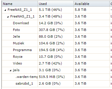

JFD
Jul 25, 2016
46
@dlavigne thanks for your reply. Since I have been away from all this for some time I hope you can give me a step by step guide or so. I don't think I have a complex system with 1 pool (3 hard disks) with 7 folders and 1 jail/plugin (sabnzbd).
But if I could update without needing to recreate settings for all this that would be great. So could you be so kind to tell me what to do? Exactly what to backup and how, how to install 11.1 since I cannot select in in the interface. The boot device is USB. Do I need to clean it up?
with kind regards, J

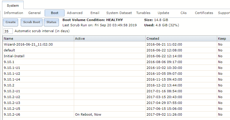

JFD
Jul 25, 2016
46
the manual update to 11.1u7 was successful. But I get the message: New feature flags are available for volume FreeNAS_Z1_1. Refer to the "Upgrading a ZFS Pool" section of the User Guide for instructions. Do I upgrade the ZFS Pool? And when do I do that? After updating to stable 11.2 is my guess. Please help me if you will so I am up and running on the most current version ;-). Thanks so far
JFD
Jul 25, 2016
46
@dlavigne I am on 11.2U6 now. n00b as I am ;-) I noticed that I need the legacy layout to manage the jail that is used for downloading with VPN and sabnzbd. I really like the new layout so I now have 2 open questions:
1: can I "update" the legacy jail to the new interface?
2: do I or do I not update the ZFS pool? It seems like I don't need it but there is also no problem to update. I now get an alert on this to do so.
