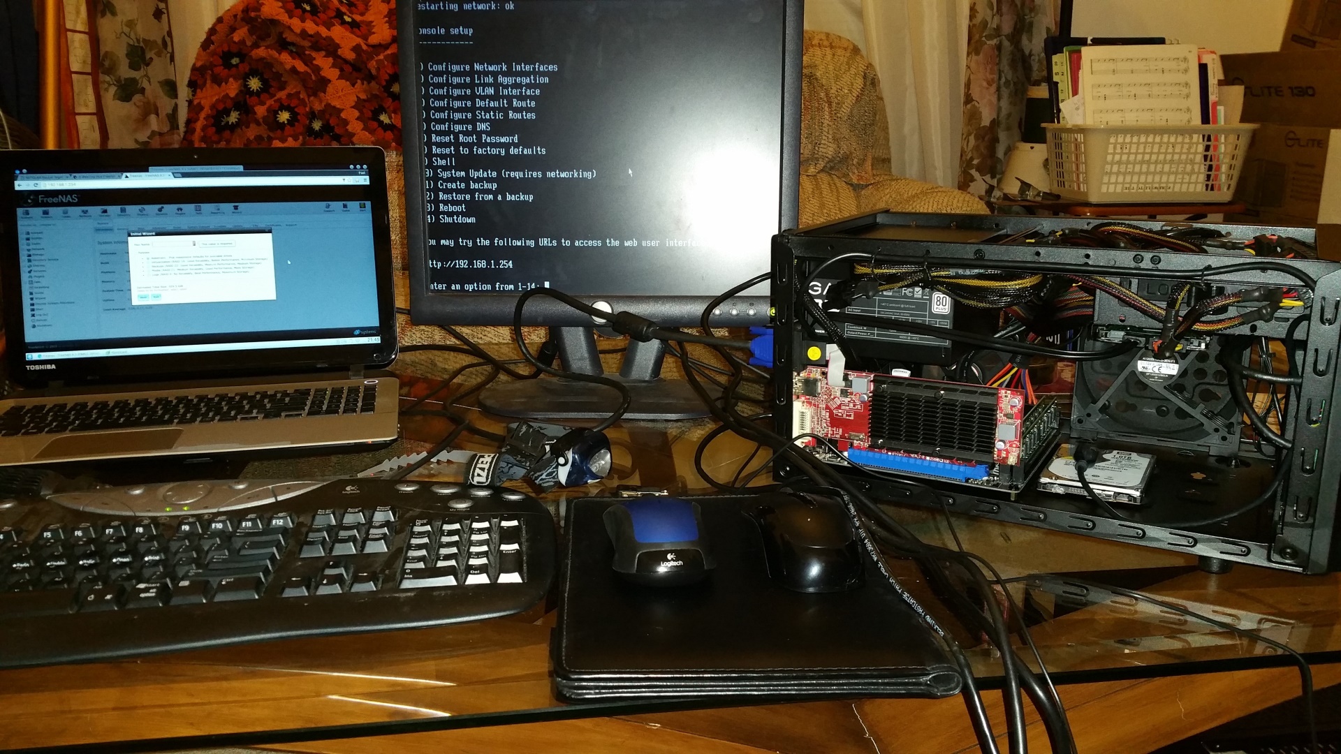

YeongMin
Feb 26, 2016
5
Built. Set stuff in BIOS. Installed. Set static IP. Config for headless. Boot, create new mirror volume on the two SATA via Wizard. Import data from USB Disk. Stuck at 78% (attempted twice). Will probably do manual transfer via USB -> ethernet to NAS.
