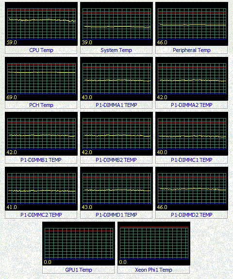

For future reference:
Changed the fans to three Cool Masters I had on another SM chassis and temps at start-up were:

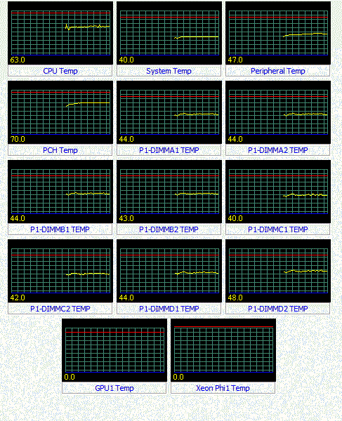

12 hours running:
Still gonna look on those scripts on my two servers. They are on FreeBSD VMs though ... but got the same issues, so not FreeNAS specific.
