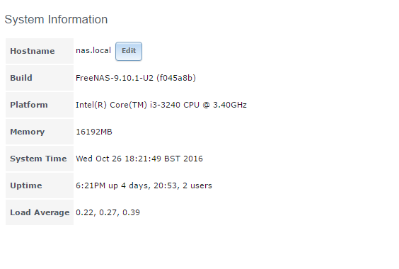

I've just setup a new NAS on a HP Gen8.
Details are:

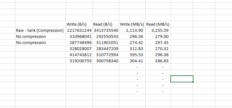

I do a dd to check read and write and the write performs ok - average of 316MB/s over 4 or 5 runs.
The read confuses me - over the same runs it averaged 285MB/s

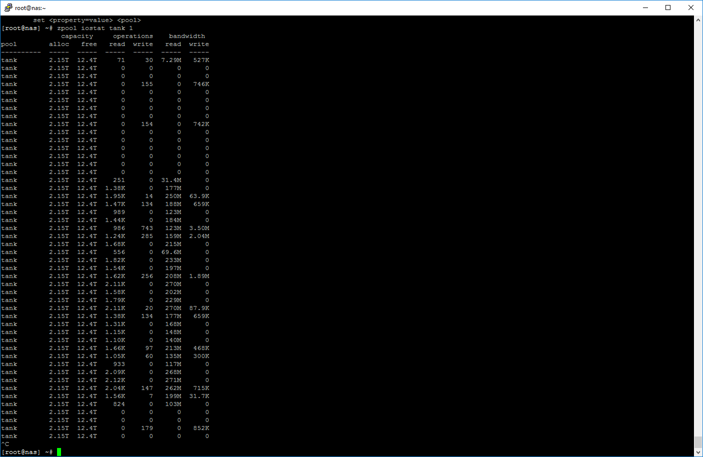

While doing that I had a iostat running. Both -v and without -v
The with-v shows that during the read the the spinny-disks are reading 40-50M (is bandwidth MB/s?) while the SSD is reading 2.12M and writing 16M
As you can see above, the read performance does not look like it's coming from RAM or from SSD.
The without-v option looks like such
