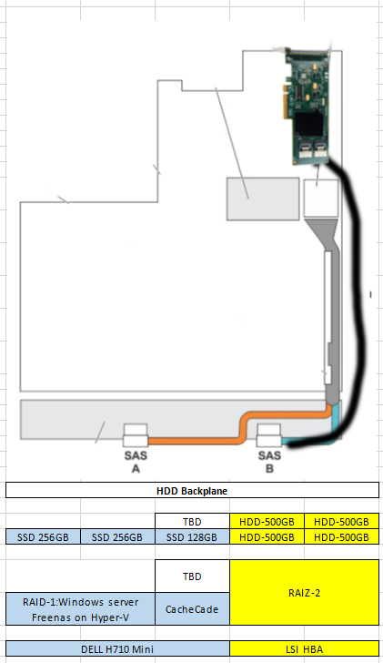

There are 8 Hard driver can insert to the backplane then my plan is:
- Use Dell PERC H710M and run RAID 1 to install Windows server and Freenas on Hyper-V, two HDD left in SAS-A, I am going to use for backup and cachecade.
- Disconnect the SAS-B connector then use SFF-8087 to SFF-8087 to connect 4 HDD in the backplane to LSI SAS 9211-8i and create a RAIDZ-2.
Image below to explain my ideas, sorry my english is not good. I try to read a lot from the forum to update my own business system.
hope you guys got my idea, I have some question please help if any.
1. Use FreeNAS as storage to share file, folder. Is it OK to run it on Hyper-V? I do not need the highest performance of FreeNas but need its stable, reliability.
2. My idea to separate HDD backplane is OK?
If NO. I will be going to build new base metal to run FreeNAS. BUT it takes money and more noise in my department.
I am not an IT guy, but I really love to build home servers, home networks. Putting data into the safest space is my goal. So please help the best solution for me if you have any better idea to live with windows environment :)

is there a problem you are trying to solve by bringing freenas into this mix? trying to virtualize adds a complexity that, from what I can see here, may not accomplish much.
that said, the biggest problem I can see is if hyper-V can do PCI passthrough and if hyperV will run freebsd; if it can, it looks like your plan is pretty well thought out, though your total storage space is going to be fairly limited. I know of no reason the backplane split wouldnt work other than if it was a single expander, which it shouldnt be with SASA/B.
you write "T720XD " is an option but I think you mean "R720XD "?
I don't think going 1u is exactly going to reduce noice, often the 40mm fans are WAY louder to make up for being so small, in addition to massively cramping your storage options. I would seriously consider the r720xd instead for drastically more flexibility.
of course, both the r620 and r720 would be even more ideal, but if you have cost/space/noise limitations, I think the r720 would be the best choice, unless of course it's drastically more expensive (like double the price)
(btw, your written English is quite understandable)

Thank @artlessknave for your comment.
I am going to buy R620 or R720XD and my plan to set it up like above, I asked sales, he said R720XD provide more noise so I decided to get R620. The price is not too different about 50 to $100 only.
I am going to check if Hyper V can do PCI passthrough or not, Could you please let me know the question if possible? If no, I will try to another plan.

It appears that Hyper-V passthrough is possible with caveats. You'll need to have a processor that supports the latest VT-d virtualization, and whatever device you pass through must become dedicated to the VM (i.e. you can't split half of the ports of the backplane between host and guest, it's all or nothing per PCI device).
Some information here: https://devblogs.microsoft.com/scri...er-v-vms-by-using-discrete-device-assignment/
Depending on what you do with your Server 2016, it might be sensible to flip the setup and put that in the VM instead. With the latest improvements coming in FreeNAS 11.3, I've put my primary Domain Controller as a VM in FreeNAS and everything works quite well, but if you're using more than 16 cores or have extra hardware in your Server 2016 perhaps that might not be the right direction.

One more question i would like to ask you guys. new server use dell perc H710 Mini. Is there any problem or risky in the future if I create a raid with one hard drive. is This step make FreeNAS can see the hard drivers? Then I can create Vdev from them.
in his original design he is splitting the backplane by using 2 entire controllers (h710m+9211-8i ), so I'm pretty sure this doesn't apply.
I have never used hyper-V myself, so I just don't know the answer, however, it would be crazy of them not to since all the other hypervisors do to some level.
I not sure I fully understand the question, but you can't make a "Redundant Rrray of Inexpensive Disks" with only 1 disk, the whole concept of RAID requires 2 disks at the minimum. many controllers either have "jbod" or "raid0" modes, but most of the time these are bad ideas to mix with zfs; you do not want to run zfs on top of anything RAID - zfs is an all-in-one solution that replaces RAID controllers, file systems, volume managers, file verification programs, cache programs, etc, and requires direct access to the drives.
too many jbod and raid0 modes still add metadata and obfuscation to the disk that hide important things like disk health and SMART status that confuses zfs and is known to murder pools. if the h710 has IT firmware, you can flash it, but since you aren't yet sure of your design, just get the 9211, then you have both options to test with and decide your final build.
if you are using freenas as the host, unplug the h710 and use the 9211-8i for both backplane ports. you will have access to all 8 drives in freenas and can make whatever number of pools you want.
(note that the 9211 and I think the h710, are SAS2 only, so you will be unable to use speeds over 6gb/s, though this is realistically only a concern for if you were to upgade to SSDs)

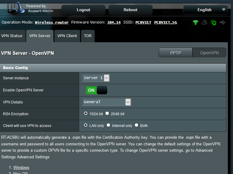

Thanks for your sugestion,
I choiced PPTP because it's eaasy to instal and connect from Windows client. My router also have OpenVPN build-in. more easyer for me to control and manage, Free nas have Open VPN but I am not an IT guide, less skill in commnad. So i will going to use VPN in router.

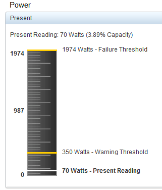

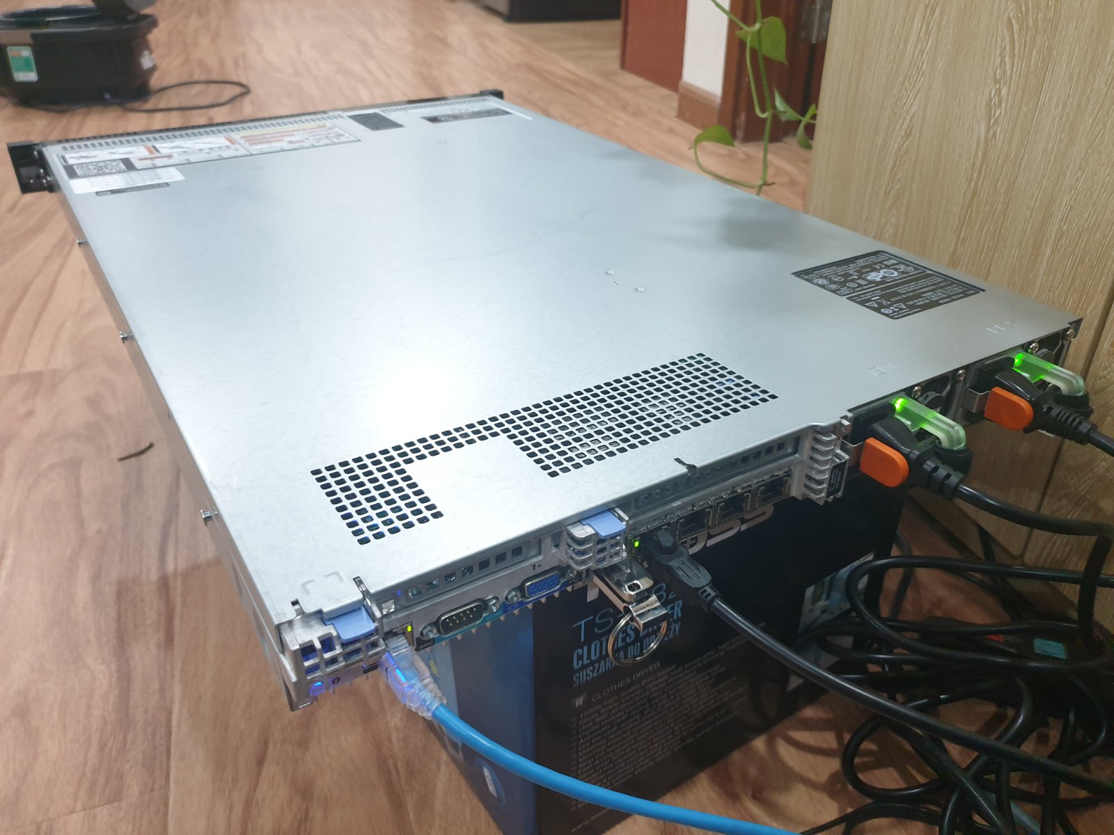

My R620 just received last night. Still waiting for BHA card and able ship from ebay.
The noise is fine, i change speed to static speed by command the speed enough to keep temp aroud 40 to 50oC. but just 32Gb ram available, i need order more
Power consumption is quite good, i am impress with dual xeon E5 2670 TDP 115W
ideal mode is 70W

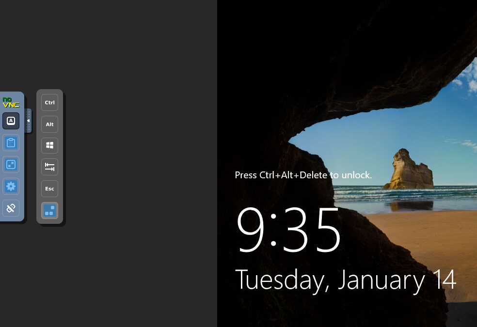

Hi eveyone,
I tried to install windows server 2016 as a VM in FreeNAS 11.3 RC1
I saw some guys on youtube, he can install windows variant there. but I got a problem, VM can start but not responding, get stopped until I restart. I can not sent Ctrl+Alt+Delete from UI, also can not use remote desktop to log in the VM.
Does this 11.3 problem or another version also have this isssue?
