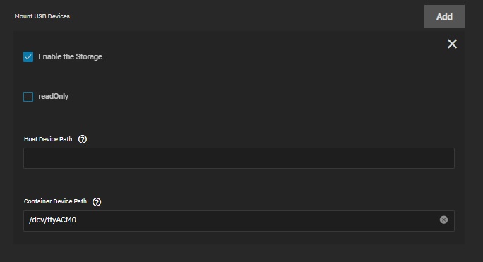

I'm trying to find the address of a USB Bluetooth adapter so that I can mount it to Home Assistant.
I have tried "lsusb" but command isn't found, "lsblk | grep sd" but seems that doesn't show usb devices.
I'm not sure what to do to find the address

Address for my USB dongle for home assistant is /dev/ttys1
Found the address by going into Services / UPS. There is a drop down menu for the USB connection for my UPS... and that had the HA dongle also listed.
considering I only have 1 USB plugged in, it may just take the 0 or 1 spot. I'll try a few. Also I tried the UPS service but it wont start, probably because I don't have a USB UPS. but thank you, there maybe a chance for me to find it in a drop down menu somewhere.
EDIT: no dice, no matter the ttys I try HA will not deploy, the logs spam this. since it is the same no matter the ttys. I'm going to assume that they didn't work.

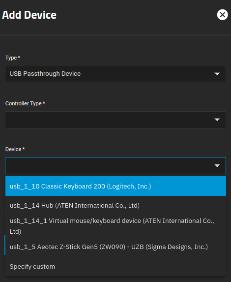

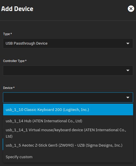

You could try to create a VM (no need to start it or install OS), click to edit the VM devices, then in the top right click Add and select Type USB Passthrough Device. There is a Device dropdown, maybe your adapter will show up there.
It likely will show up there, but that wont give me the address to the device, just the name of it.
I may have to just run HA in a VM. Which is a same because the TrueCharts app should be able to pass it through :(
