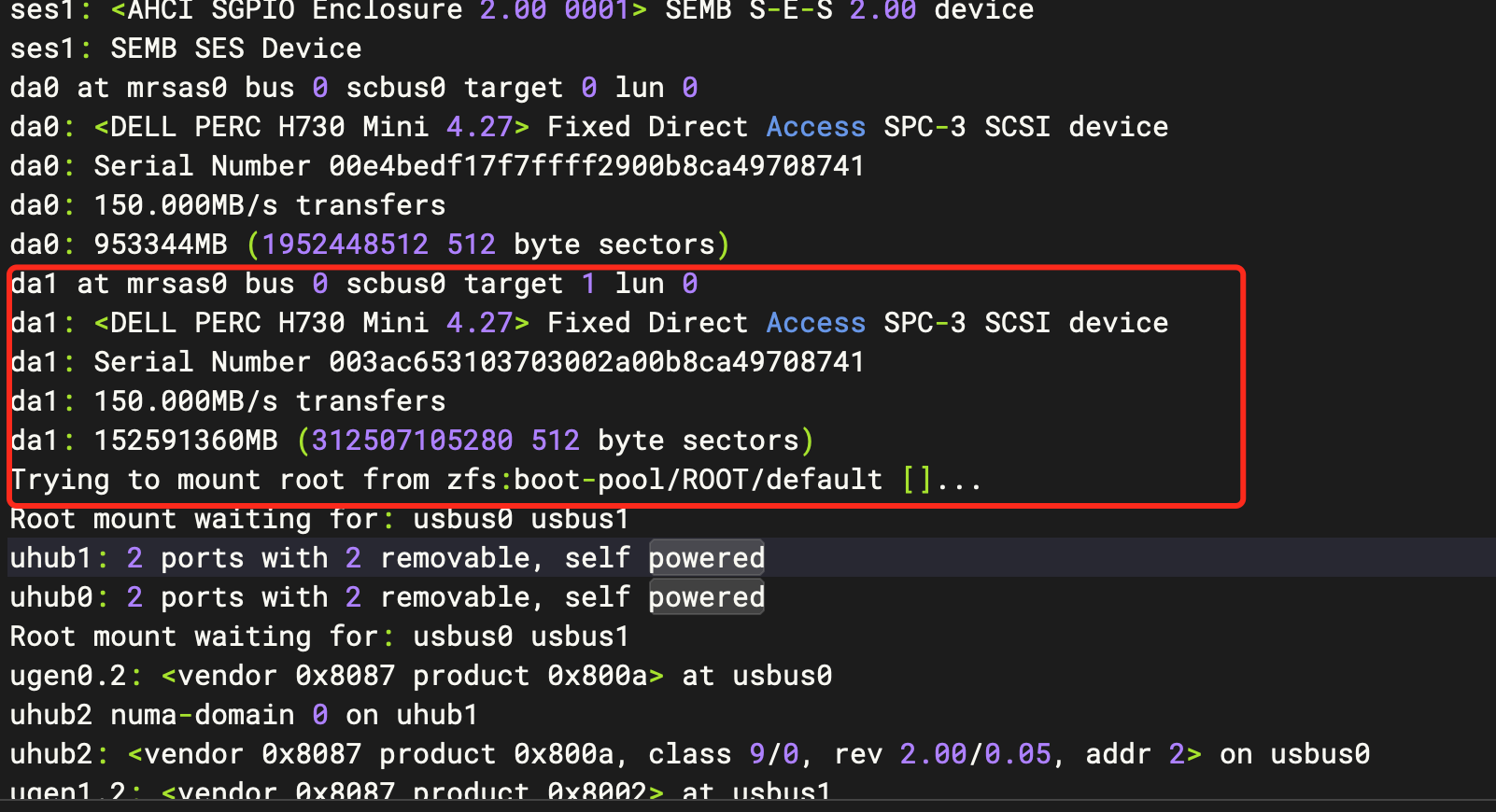

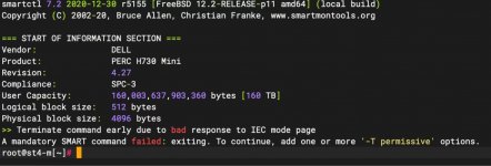

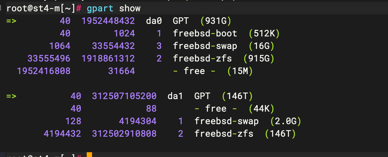

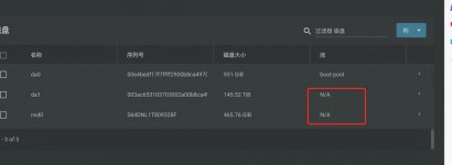

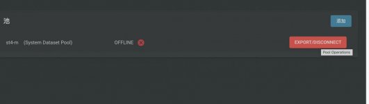

Help!system dataset pool OFFLINE
heychoo
Oct 17, 2022
4
I am sorry for my english
I will show pictures the more the better for help me
thanks thanks thanks

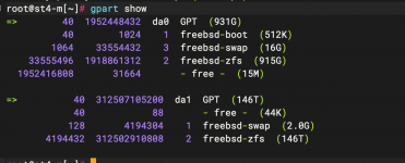

heychoo
Oct 17, 2022
4
add two pic
jgreco
Resident Grinch
May 29, 2011
18,680
add two pic
The PERC H730 is a RAID controller and is not usable with TrueNAS. Please see the article at
You must remove the PERC H730 and replace it with an LSI HBA controller, such as an LSI 9300-8i.

Thank you. Can I mount or export the data of the hard disk pool in my current situation
jgreco
Resident Grinch
May 29, 2011
18,680
I don't know. Possibly. If it previously worked but does not now, it may be that a driver change has rendered the card unusable. You may be able to roll back to a previous boot environment. However, even if rolling back makes it work, be aware that this is not expected to work well in the long term. Please do not think that you can roll back and just use that older version forever. It is expected to be problematic in various ways.
