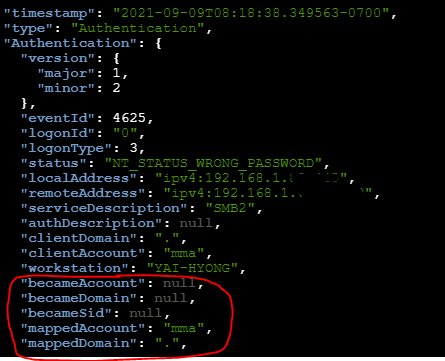

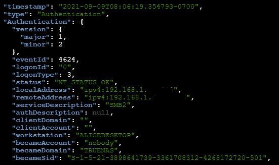

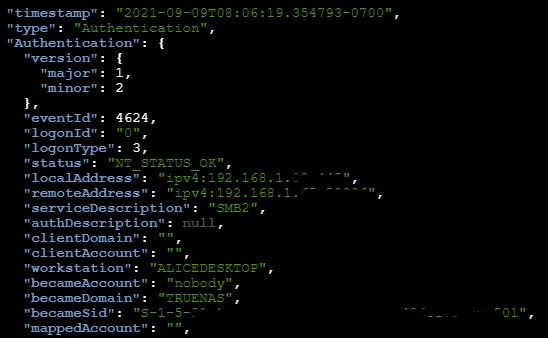

Thank you for the command line. I took a screenshot of a successful log in from one computer and one from the computer with issue. I can see it says "NT_STATUS_WRONG_PASSWORD", but i don't understand it enough to decipher other information to know what's wrong. Both computers are trying to log in using the same account and password. If you see something wrong of the authentication log, please point me to the right direction. Thank you!

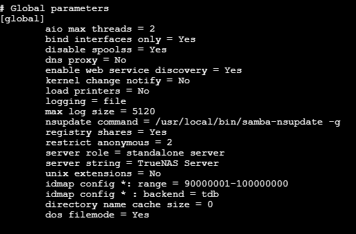

Top one is passing empty creds, getting what looks like a SID ending in 501 (not clear in pic), which means GUEST account, which is also consistent with `nobody`. Second one is trying to authenticate with an account `mma` and failing with WRONG_PASSWORD (which usually means the account exists on our server, but has a different password). What is output of `testparm -s`?

That's interesting, because the top one is the working computer logged in under "mma" account, and the second one is the problematic computer failing with the same account and password. Don't know why the first one shows "nobody" account?

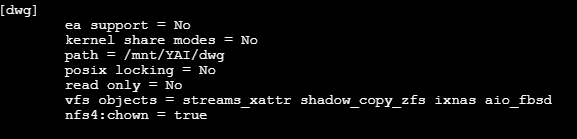

This is the output of 'testparm -s'

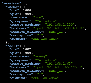

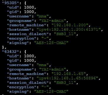

I'm not quite sure what to look for, these are the output from the SESSIONS command - there are only 4 sessions.
First one is my Computer (say computer A), logged in under "mma", no problem
Second one is Computer B, logged in under "ayong", no problem in connecting, but had "read only" issues, which is another problem altogether. I bypassed the issue by logging computer B under "mma" - as shown in the last session. no problem
Computer C's failed log in attempts are not displayed
