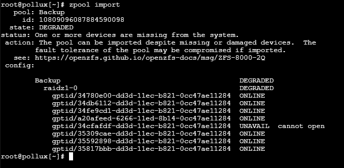

Zpool status;
My guess is thats it's not a godd idea that I can't dee anything about the "back up" pool - almost at is the LSI is all gone...

Since zpool status did not show any results, please run zpool import and paste the results in code tags here.

zpool import did give me more info;
