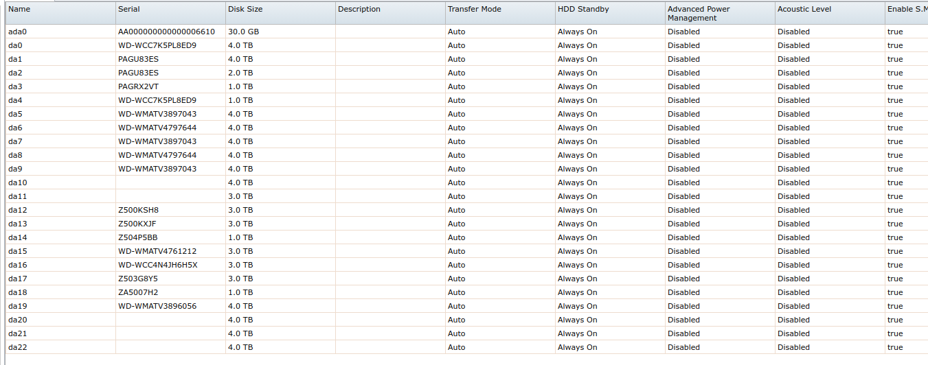

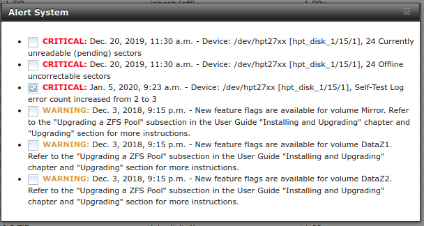

So I have started to see some fairly scary critical messages pointing at an issue with hpt_disk_1/15/1. Before I go removing hardware from my Freenas box, I just wanted to validate that my assumption is correct.
hpt_disk_1/15/1 is the same as <HPT DISK 0_15 4.00> , and is therefore da15 which is a 3tb WD with a serial no WMATV4761212

that's a...weird naming scheme, but with the massive assumption that your presuppositions as to "hpt_disk_1/15/1 is the same as <HPT DISK 0_15 4.00> ", it looks like you have it right
you could doublecheck with glabel status + zpool status -v, and match the gptid

It's the HighPoint driver in there. Hopefully there's no RAID layers in the way that would prevent an easy zpool replace operation.
But yes, this is a clearly failing drive.
