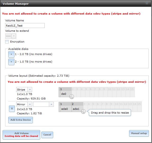

I have 3 8TB drives that I want to configure RaidZ1 with. In the GUI with the volume manager how do I do this? I have tried different options for disks and mirror and stripe and it won't let me do any of them. Can someone tell me how? I have read the ZFS primer and the Storage area of the FreeNAS guide and they are not helping much. Thanks in advance.

Post a screenshot of what you are seeing when you try to select the 3 drives.

I don't know if this is right. BTW this is not with the 8TB drives yet, I am doing a test with smaller drives just to make sure I know how to set it up when I get my third 8 TB drive.

Click the X to remove that second bar of drives. You can then drag all 3 drives in the top bar. This assumes that you are making a pool for the first time (that is, you don't already have a volume of just one drive).

As long as you have 2 bars, it thinks you are making 2 vdevs.
You want all of your disks to appear in one bar. That way you can drag the slider to select all 3, at which point RAIDZ1 becomes an option in the drop-down menu.
