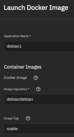

I am trying to install debian:stable. I have tried various combinations in the SCALE UI for Image Repository / Image tag:
  1. debian / latest
  2. debian/debian / latest
  3. debian/debian / stable
This latest attempt, as shown above, resulted in this error in the logs:

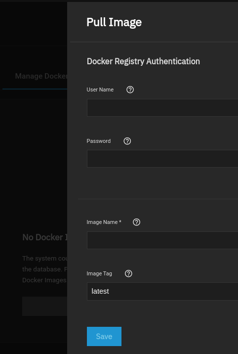

I think I found it: Manage docker images -> Pull Image.
I'll give it a try later, and then mark this as solved, if it works.

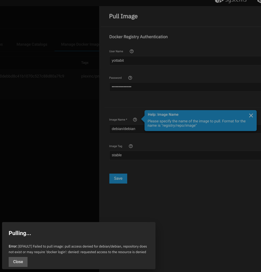

I still have not been able to figure this out. I have entered my Docker.com username & password, but I still receive the `requested access to the resource is denied` message.
Any hints? Anyone can offer?
Heracles
Feb 2, 2018
1,401
Are you using 2FA in your Docker account ? If you do, you need a special Application password for that.

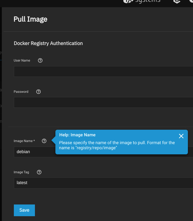

Figured it out. Don't need user/pass for Docker. Just need to fix the image name to 'docker' only, which is a little confusing considering the tooltip for the Image Name field.
