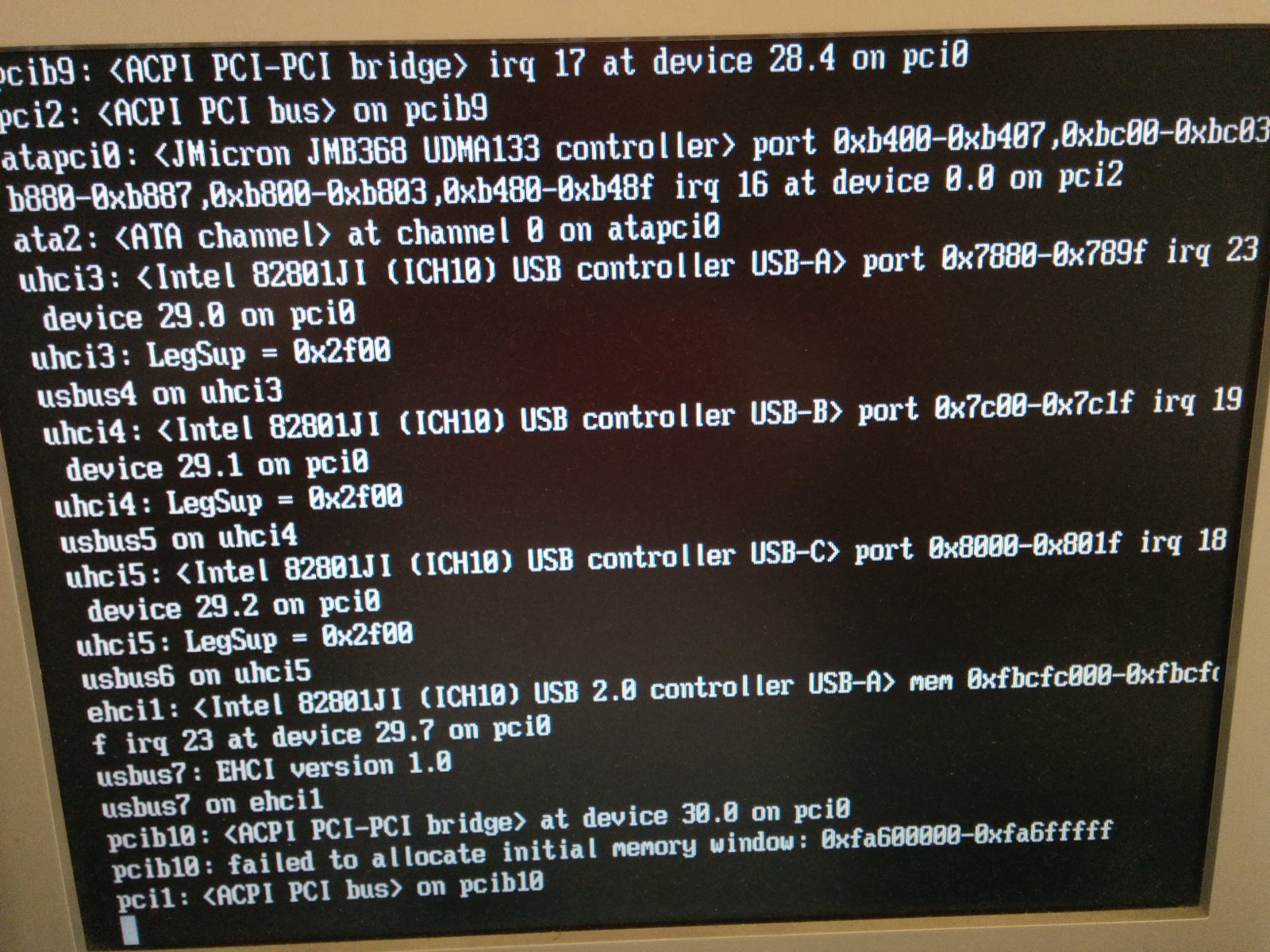

I am currently having issues install FREENAS 9.3 on to a Super micro motherboard. The specs of the system are listed below. The issue that i am having is I am receiving the following error message during my 9.3 stable install. "pcib10: failed to allocate initial memory window: 0xfa600000-0xfa6fffff.
Things I have tried:
1). What is kinda odd is if i remove one of the pci-x supermicro sata cards i am able to install 9.3 stable with out any issues. With no pci-x cards installed 9.3 stable installs without issues
2). Tried the same setup on another identical board and have the same problem
3). swapped ram slots
4). Tried installing with one cpu installed vs 2
5). changes come of the acpi settings but instead of receiving the memory window error i get a fatal 12 error
6). tried installing 9.1.1 and it installs but on reboot another error occurs (might be choice of flash drive i am using, trying a different one as we speak)
7).using different ram
8). check bios REV and the newest version is installed
I seem to have narrowed it down to the PCI-x cards as being the cuplret. Not sure if the third card is exceeding the ACPI allocated memory window or there are issues with the BIOS rev. Any help would be greatly appreciated. Thanks

switched flash drives to a sandisk cruzer 16gb and 9.1.1 x64 installed fine with the 3 supermicro sata cards installed. Now i am really stumped.
