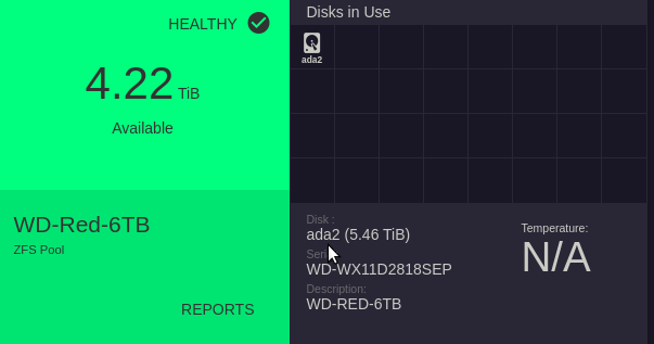

Sean Hasson
May 27, 2018
5
Im pretty certain* - At least 90% Sure that in the FreeNas 11.1 The dashboard showed the CPU and HDD Temp - It no longer shows the HDD Temp - Wondering if this was a feature removed/ not working in latest version or simply just not working for my setup in 11.2

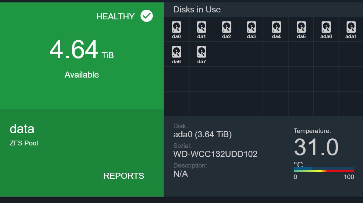

Hey -- Temps have been working consistently for me in every 11.2 release thus far. See attached. Do you have any other drive / pools, and if so, are any of them working? There were some bug reports last year that looked like your problem:
Which specific release are you running?
seems to me it is a UI bug or a glitch in updating to 11.2, but just to rule it out, have you looked directly at the drive temp to see what it's reporting?
From the Shell:
smartctl -a /dev/ada2
look for: the value that looks something like this:
194 Temperature_Celsius 0x0022 111 102 000 Old_age Always - 39
Where the 39 would be the actual temp. I did once have a failing drive that threw crazy values into the smartctl output, and I can imagine the UI choking on that.
If that looks OK though, I would consider two immediate things to try:
1) update to the latest 11.2 (it looks like those bugs were fixed around 11.2-U3). OR
2) If this system was upgraded from 11.1 to 11.2, I mught consider doing a clean boot drive with the latest 11.2 and importing my pools / settings into that. Just a wonky temp report on one drive might not be worth the risk/trouble, but if THAT issue is floating around I might worry there may be others . . .
Hope this helps a little...

Sean Hasson
May 27, 2018
5
You have to click the little disk icon.
Nope...
From the Shell:
Hope this helps a little... View attachment 35174

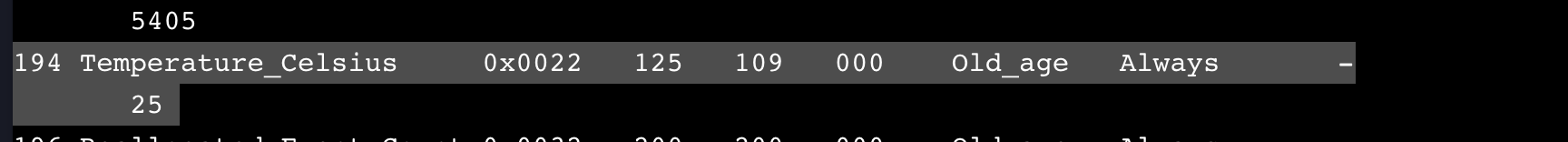

Thanks -
Found that it is reporting the temp as you suggested in shell
Im currently running 11.2 U7 - None of the other disks display it in the dashboard either - sounds like a UI Glitch or as you say may need to have a clean boot.... Useful to know anyway!!!
Thanks
Sean
