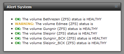

So I had an HDD die out on me. Drives die, but it is what happened afterwards that kind of bothers me:
1) I did not receive any diagnostics about this. my "root" has an email address set, and I receive notifications when replications fail, for example. On reboot, FreeNas failed to detect an HDD, and did not even send an email notification about this???? Is this normal, did I miss a setting somewhere? If one of my drives die, I expect to be notified ASAP. Am I expected to log into the WebGUI daily to make sure everything is running fine?
2) I finally understood what was going on when I went to the WebGUI. This is not something I do very often anymore. There was a blinking yellow "warning" light. I'm not an professional network admin, but if a server fails to load all its mounts, isn't this a "critical" error? When looking at my pools, the only message was "Could not get drive size" (or something similar, I don't remember). I'm not fluent in freeBSD, but can't it detect that I just plain removed the drive because it was dead? Did I "only" get a warning because FreeNAS did a wrong diagnos
3) (minor) In the Alert System window here:
The message does not fit into the actual alert system box.
I'm still a FreeNAS newby, but I expect that if an hdd craps out on me:
1) I receive an email.
2) The WegGUI notes a critical error.
Am I wrong in my way of assessing the situation?
PS: Did not find this reported yet. Sorry if duplicate.

FreeBSD 8.2 (the base system for FreeNAS 8.x) will not notice a drive failure in a zpool unless a scrub is run or the system is rebooted. We are working on the solution to this, but it involves a ton of kernel changes that aren't even in the development branches of FreeBSD, and for the moment are unwilling to unleash them on the FreeNAS user community as they are not without some risk.
A related bug is that hot spares won't kick in automatically.
Both of these issues are in our top 5 list of very important things to work on resolving, and hopefully sooner rather than later we'll get them out to the world.

I totally understand that freenas is not able to immediately detect the failure. My surprise came that when it finally did detect something fishy, it didn't say anything. I guess you are trying to develop something reliable rather than just kludge a patch.
I'm just a home user, so this is not a real issue for me, but I report what I find to help as much as I can.
PS: What about the minor interface bug in my first post? Seems like it is just a cell size problem. Was this reported before?
