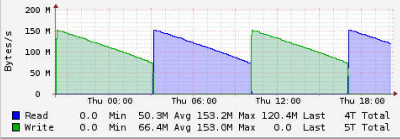

Here is a visual graph on how badblocks stressed my brand new WD red 3TB drive (most of the first two test patterns)
After seeing this, If it passes I am certain that tested drive will be great

D
Deleted47050
Guest
In the GUI Reporting > Disk then use click the + - << >> buttons for time frame scale
Have Fun
Oh nice, I was wondering if you were using some additional package or something, thanks for this.
